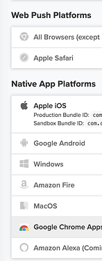

OneSignal config:
That’s great news, @JohnMark! :smiley: I see for iOS you need a .p12 file (Production Push Certificate), but for Android you need to configure it with a “Firebase Server Key” and a “Firebase Sender ID”. So I guess Jasonelle would need to be integrated with Firebase to make this work on Android?
I don’t think so it’s related with Jasonelle. You simply need to pass the value from your Bubble app to Jasonelle to Android. I’m still fresh in it :wink:
