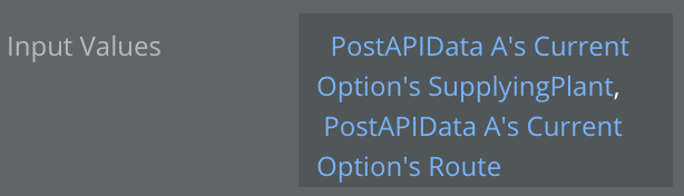

- A field named “Input Value” where I expect the user to build a comma separated list of the fields from the “Current Option”. It has to refer to itself and then “current option” instead of just a simple “current option” field, but hey, I can input it using standard bubble fields the way I want…
The input ends up looking like this:
