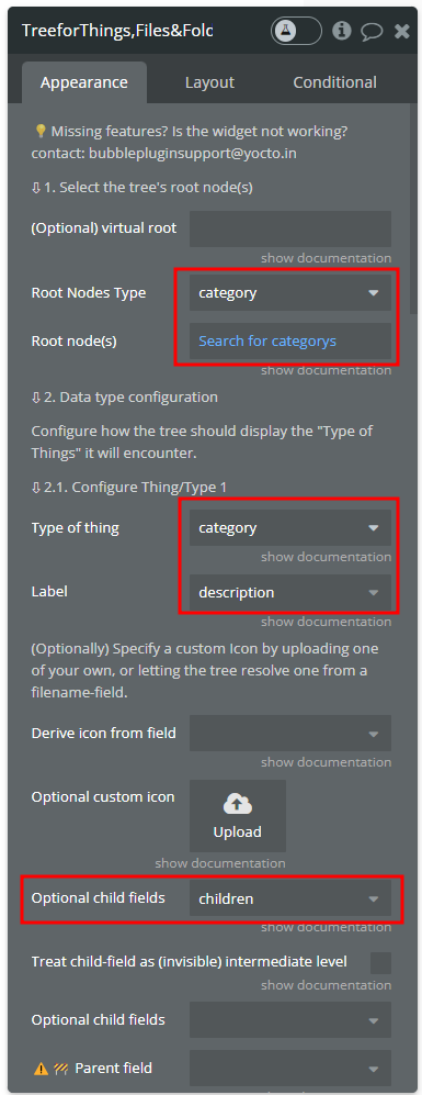

Here are my settings of the plugin:

Does your “Search for categorys” only result the Root-nodes? Or is it unfiltered and returns the whole table?
Thanks for such a quick reply!)
I’ve found the reason - I didn’t specify the condition to filter the root nodes - have just resolved it, works good now.
