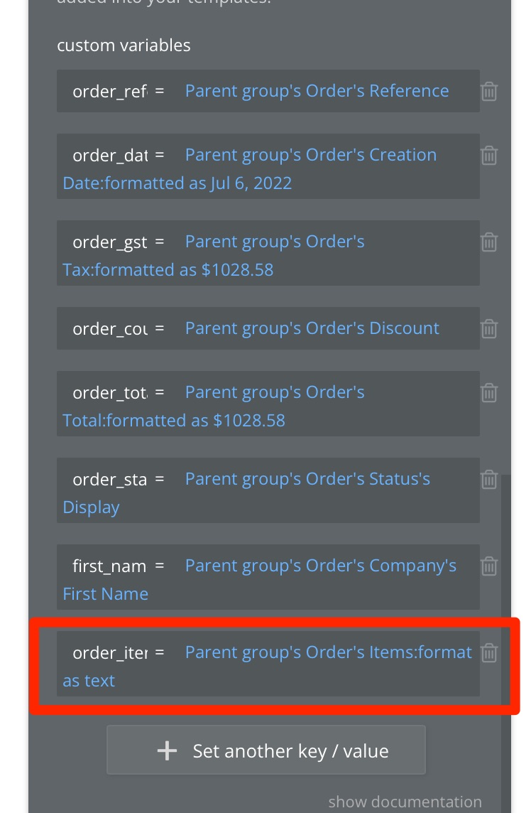

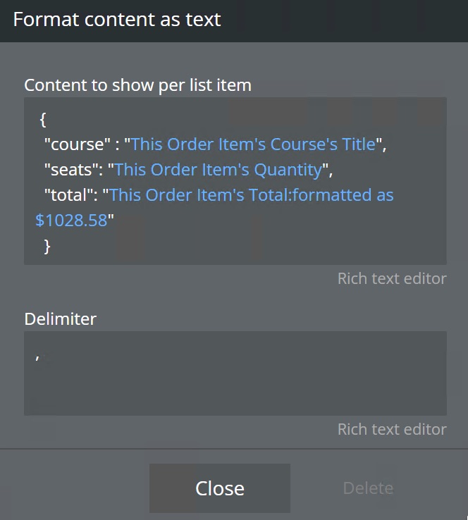

This is the JSON list I’m creating.
For this custom variable:
When I remove the order_items custom variable. The email sends successfully. So it is most definitely something I’m doing wrong with how I’m creating that list.

Also, there is a Youtube video walking you through it. https://youtu.be/WhS6s4xQ0HI Basically, the whole point of this Plugin is to avoid having to do the JSON handing within Bubble workflows which is possible, just very easy to screw up. :slight_smile:
So though the example uses the Receipt template - the same technique applies to any template where you have a list of descriptions and amounts. The lists are both Bubble lists of Texts. In your case what I would probably do is join up course & seats to be one text and total as the second list of Texts eg
"Cooking (3 seats) " , "Cleaning (10 seats)"
"£30.00", "$60.00"
Hope that helps :slight_smile:

I’ve made an example here (look down the page a bit) - Postmark Template Plugin of how to join fields and reform them into a list.
Basically the Bubble trick of “format as text” and then “split by delimiter”.
