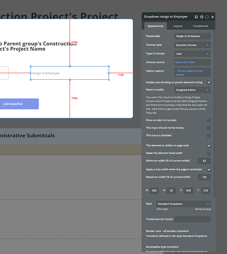

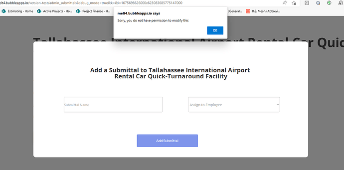

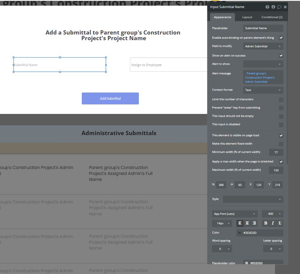

In my app I would like to send data captured in a pop-up box to a list that is visible when the pop-up box closes. However bubbl.is has an alert that shows up everytime I look to use the pop-up box to collect data. The alert says " you do not have permission to modify this". I looked at the settings for the form and the input boxes are asking me to update the privacy setting. I tried to write privacy setting but I don’t think it is working. Could someone plese help me?
check the field “Allow auto-binding”
I did check that box. It’s still not working :slightly_frowning_face:
don’t forget to check related fields
This did help bind the item to the project. However it is not showing up on the list now. Do you have an idea why the data is not being passed from the form to the list?

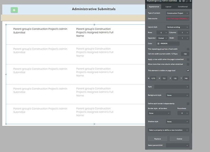

Can i see some screenshots?

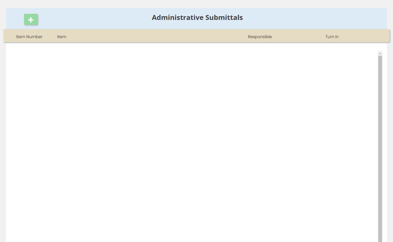

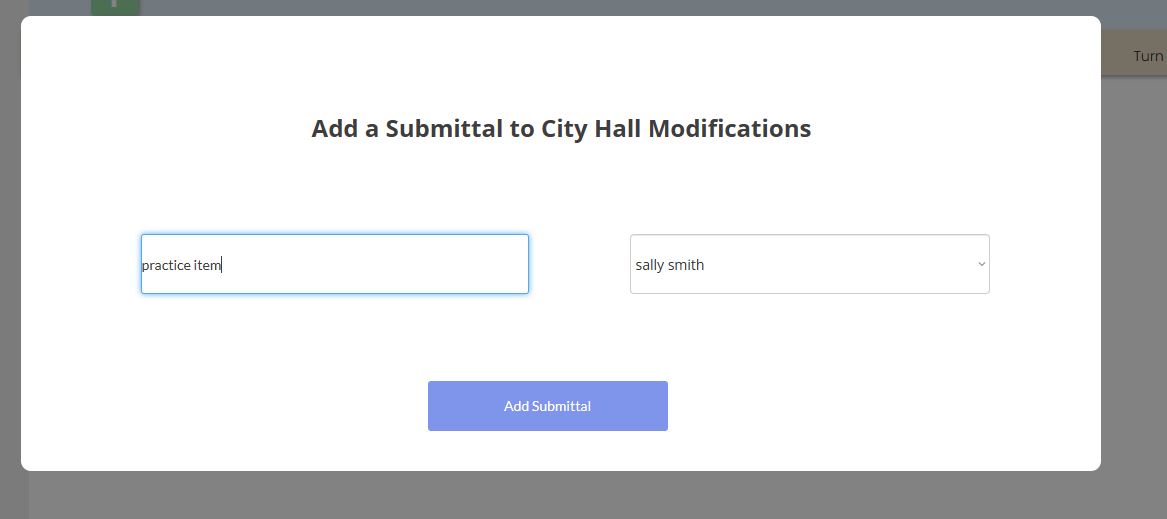

Here is how the process goes:
  1. When you click the green button a popup appears asking you to add to the project
  1. The information entered into the popup box is saved to the project we are working on like this.
changes

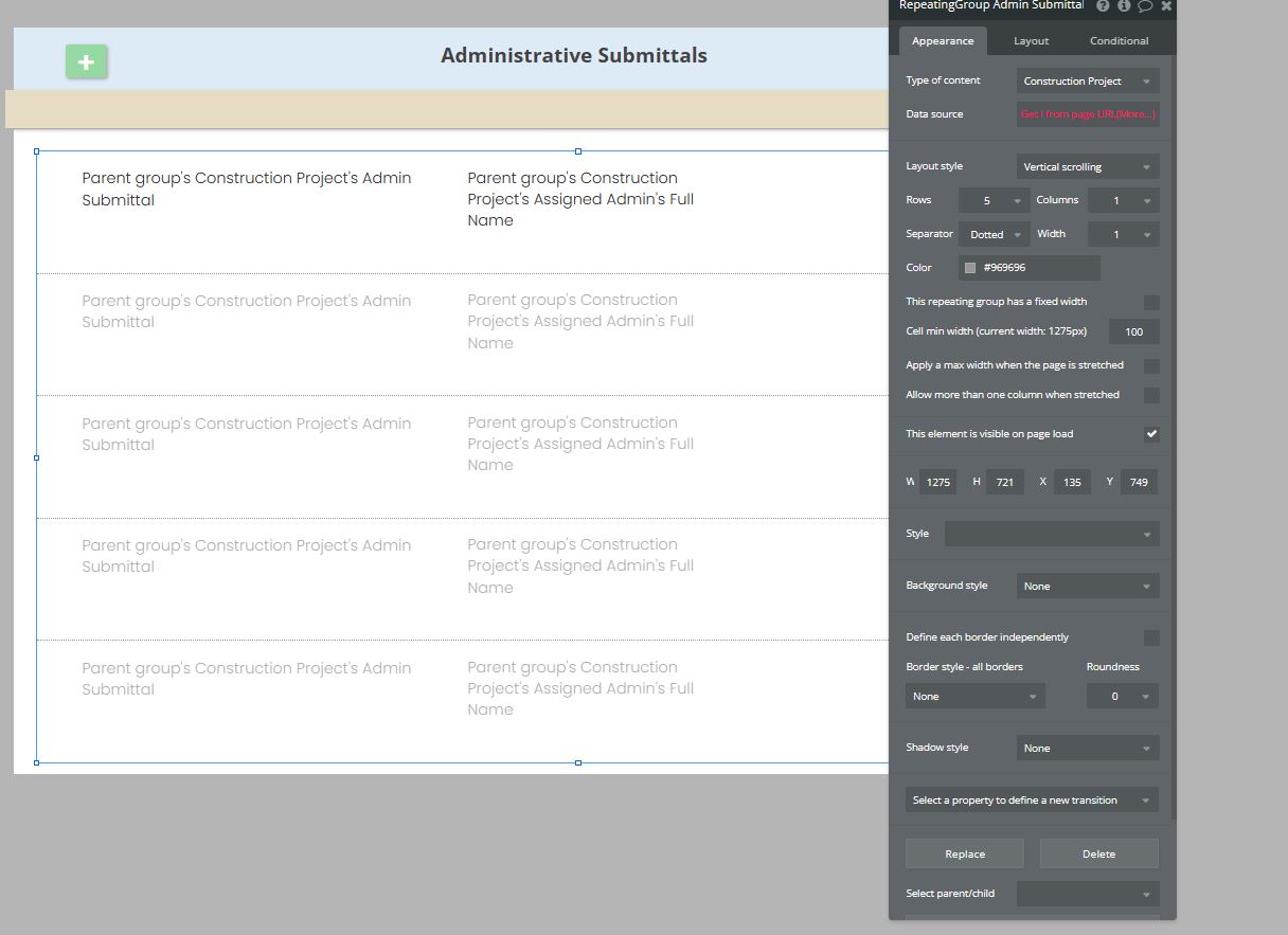

  1. The list items are sent to the repeating group
  1. I fixed the privacy settings to allow auto-binding
  2. But after all of that the new list item is still not appearing when I add to the list

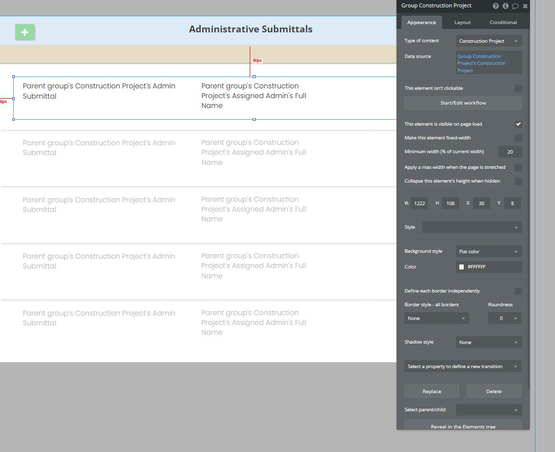

You don’t need the “Make changes to thing” step if you use auto-binding. Also, set the data source of RG properly. Shows a red light.
