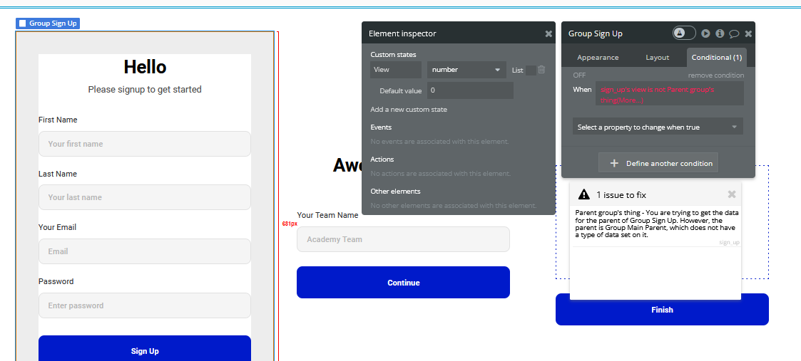

Hello @Jeremy, I’m just starting your lesson (Getting Started in Bubble: Building Your First App). I have a question about 2nd chapter starting (at 15:30). My condition "sign up’s view is not " is not getting 0 when selecting parent group things. Can you suggest me the reason?

Here is project screenshot
In the video, the condition is sign_up's view is not 0, so all you have to do is type 0 at the end of the expression. Why are you trying to use the parent group?
As the error message says, you’re trying to the parent group’s thing as a data source…
But the parent group does not have a defined content type.
Just trying to follow video instructions.
In the video, the cursor moves on parent group things but the audio says 0 :crazy_face:
Thanks for the help @mikeloc
