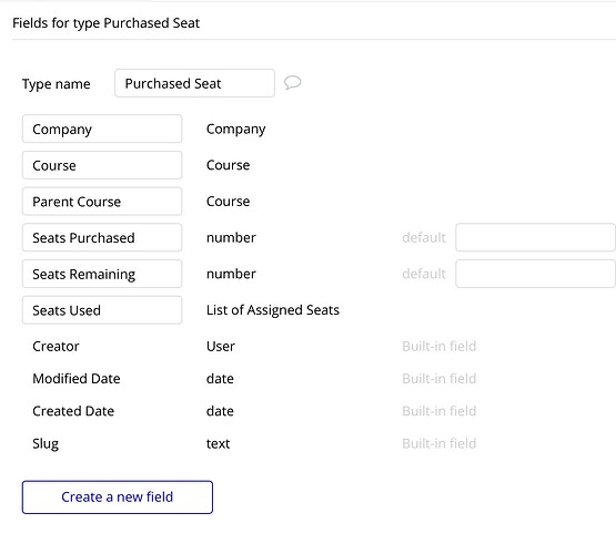

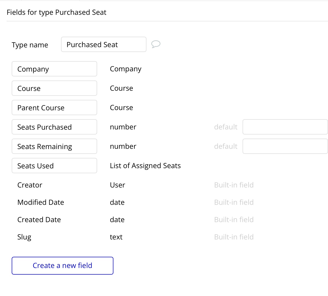

I have a data type that references another data type, but for some reason when I’m setting a custom state, I can’t navigate the tree to reference a thing connected to the data type.
So a purchased seat has a course that I should be able to reference and in conditionals in the workflow I can reference it, but not the value.
What am I missing here?
