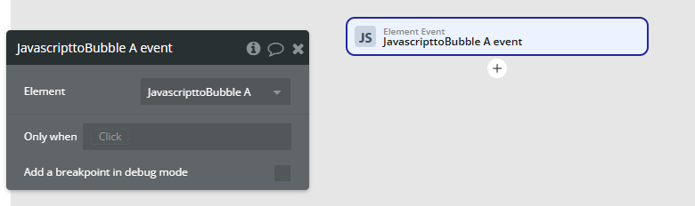

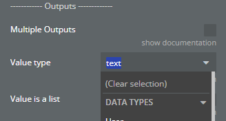

To simplify, your issue is just getting the returned values from your script to Bubble. What you’d do is just return your value to a J2Bubble element. Make sure to Publish value and to ensure that there are no sync issues, we’ll use Trigger event.
Don’t forget to set the correct output values.
Store the Value
Return your final script to bubble_fn_example(res). To retrieve the value store it in a state inside a J2B event. Using the event ensures that there won’t be any sync issues.

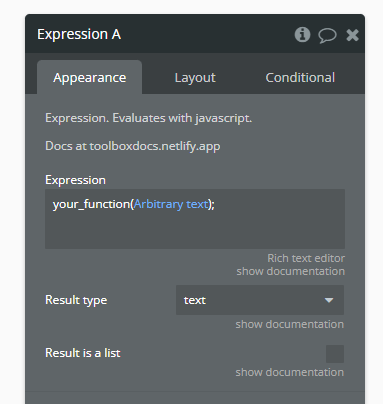

Alternative: Using Toolbox’s Expression Element
Write your function as a HTML script in a HTML element. Call it in Expression. I usually use Arbitrary Text operator to store values. Easier to read.
Value will be returned as the element’s state.
