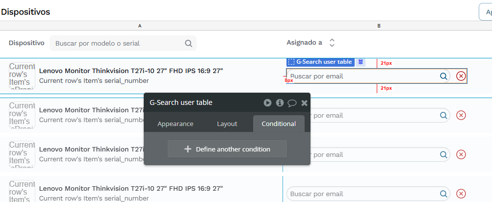

Hi, is there a way to reference elements inside a table cell, from any other place than the cells on that row?
For example, I have an element ‘G-search user table’ inside a cell of the repeating row, and I cannot reference it from any other place that is not a or in a cell in that row, not even from the row itself, let alone from outside the table.
The element:
Trying to reference it from a cell in the same row (it shows):

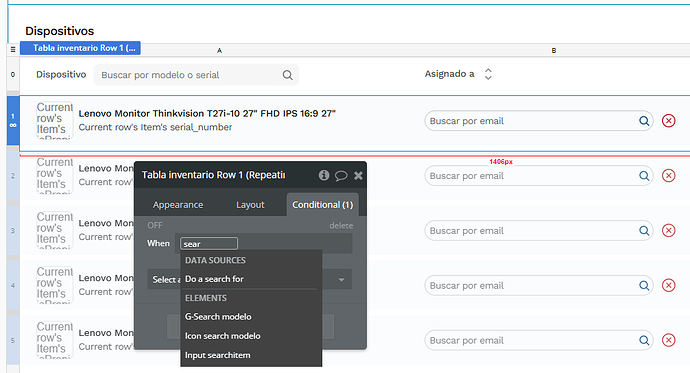

Trying to reference it from the whole row (doesn’t show):

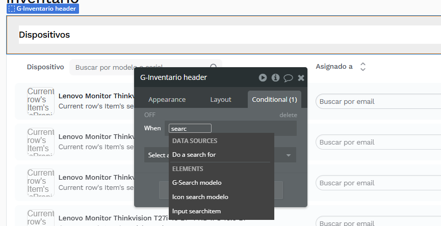

Trying to reference it from outside the table (doesn’t show):

You can’t reference elements inside a certain table’s row from outside that row, just as with elements inside a RG cell. There is no way to tell Bubble which repeated element, among all those repeated in a table or RG, you are referring to.
Makes sense, the only issue is for example when I want to add a condition to an element outside the row or the row itself, that references an element inside a cell. I.E. if ‘element inside cell’ is visible, ‘element outside row’ isn’t clickable. I get that there would be problems as to which ‘element inside cell’ of which row we are referencing, but it could work for all of them, as in if in any row that element is visible, the condition is true.
Is it an option to place the element that is outside the table/RG inside each of the row/cell?
Otherwise you’ll need to comunicate those inner elements with the “outer world” in a fancier way
  1. Updating a custom state of the table/RG itself
  2. Trigering an API workflow
