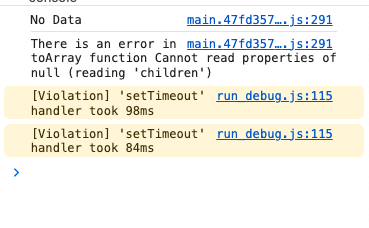

When I am in the debugger, but not actually debugging anything, the groups switch seamlessly as expected. There is no visual delay. I can see this in the console after clicking the button.
Screenshot 2024-10-20 at 10.56.14 PM

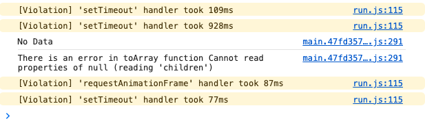

But when I turn off the debugger, the visual delay starts and I see this in the console.
Screenshot 2024-10-20 at 10.58.13 PM
So clearly something is working differently. I realize there is some sort of timing error (which is not my favorite!).

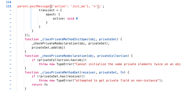

Does anyone understand what the two timeout handlers are above the “No Data” entry? These are what is causing the delay. When I click on run.js:115, I see this code:
I don’t know how to interpret this. Any ideas what I can look for?

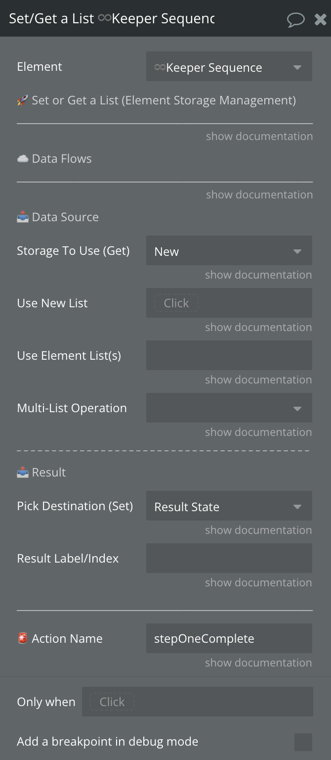

I put my custom event to reset filters first, and the last step in that event was a Keeper action that just set it’s “result” to empty. I gave it an “Action Name” so I could use that to trigger the next step.

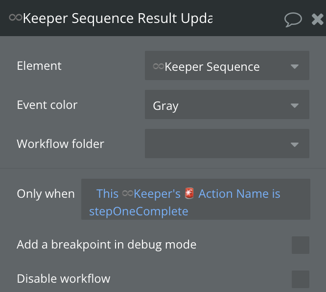

Next, I created an event that triggers when a Keeper’s result is updated and the Action Name matches.
Finally, I placed my Run Javascript step in that event.
Now, everything runs as expected/desired without the debugger. So, using a Keeper in this way is one way to make sure steps execute in a required sequence.
