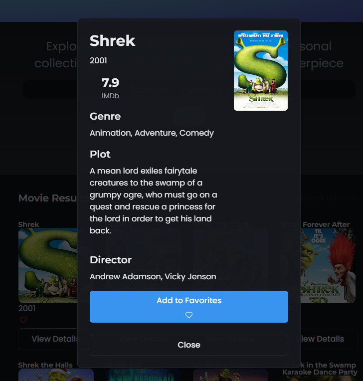

if im pulling data for a popup window is it by pulling data from the parent group ?
You need to use display data action to push current cell data to the popup. Display data in popup > show popup
thanks!
tried several ways, im trying to use display data in the popup work flow
is it correct?
if it dose i cant bind the data to the pop up for some reason it keeps it blank
MADE IT !
