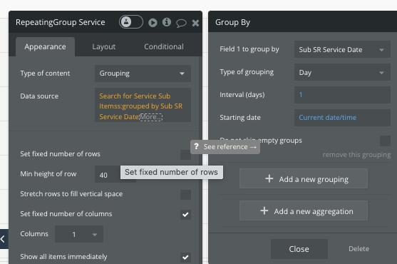

I’m working on a calendar view that works/looks like the iphone daily agenda view. But it breaks when I try to Group by date. Just as a heads up… I’m saving the Service date with the time included. I would want to group it by the whole day.
Does anyone have any direction to give on this?

So then I tried a different route of creating a contraint on the service date to equal the current date, but it didn’t work.

Hey @andy31 :wave:
I can see how that is difficult to pull off. Here is an example of one way to set it up. Is this what you were trying to achieve?
Editor: Repeating Group Calendar | Bubble Editor
Preview: https://repeating-group-calendar.bubbleapps.io/version-test/calendar_grouping?debug_mode=true
Hope that helps :blush:
This worked like a charm! If I could hug ya through the screen, I would! But for now, here is an emoji lol! thank you! :hugs:
