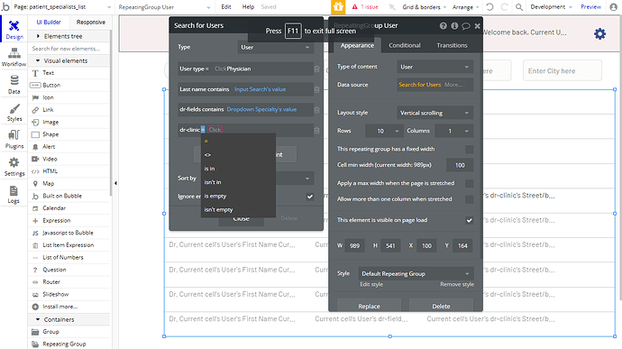

I also have input boxes that filter physicians according to their clinic’s region and/or city.
The problem is, upon adding constraints in the repeating group, dr-clinic does not have any option for “city” or “region”, as shown in the screenshot below:

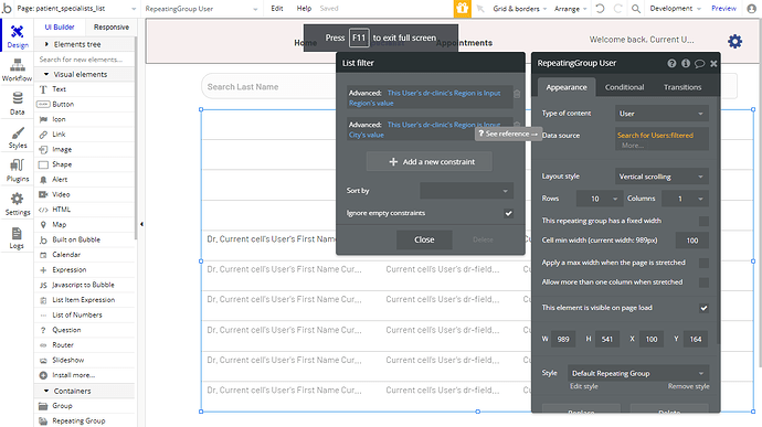

I tried the solution from this link http://forum.bubble.io/t/filtering-lists/64348
the problem is, upon adding the advanced filter, the repeating group now shows an empty list, despite ignoring empty constraints:

They way your filter is set up, it will only find if the input is EXACTLY the region’s name… (including capital letters)
If you want to match any search you should create a new state “input Region search”, set up a workflow → Every time Input Region’s value changed → set state input Region search → Input Region’s value:lowercase
Then try adding 2 filters:
first filter
This user’s dr-clinic’s Region:lowercase CONTAINS state input Region search
and the second filter you do the same, but for the City…

Another way, you can instead of using “inputs” to search the Regions and Cities,
You can set Dropdown elements → show Dynamic options (Search for Clinics’s Regions) → then you can set up the filter for ‘Advanced: This user’s clinic is Dropdown’s value’ (ignore empty constrains)
This worked! Thank you very much!
