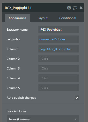

The BDK RG tools should do the trick here. You’ll need to place the RG Extractor into cell 1 of your repeating group, and then set the data spurce and type for column 1 (it looks like yours would be your Base input field’s value). Place the RG Data element outside of the RG. In your ‘Total’ field, have the data source be ‘RG Data Column 1 List: Sum’ (the sum is important as it’ll total all of the values together).

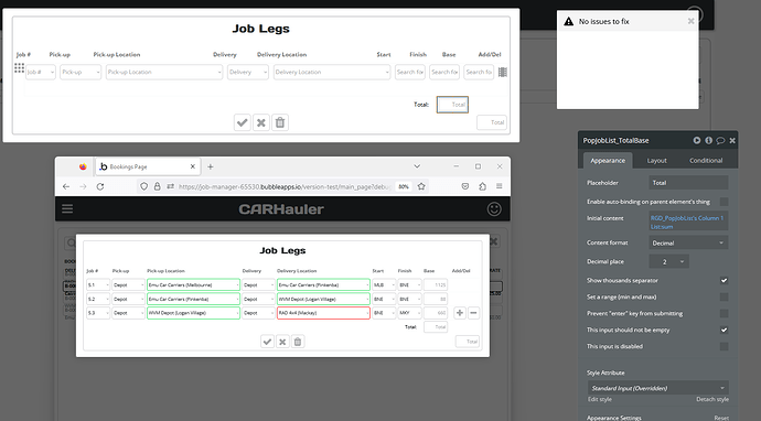

Yes, I thought this plugin would solve the problem, there’s obviously something I’m failing to understand here. I had another shot at it & set it back up the way you described (which is how I initially had it) but still can’t seem to get the expected result (please see below):
The setup is shown below also:
Thanks for taking an interest & the time to suggest the above, appreciated…
What happens if you use a text field for you total instead of an input field? Does it display the total as expected? Sometimes input fields can be weird when not populated by a human.

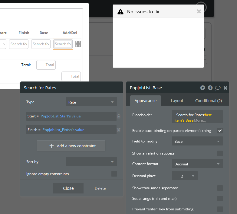

Hang on, I’ll give it a shot. I also tried binding the elements directly to the DB then using:
Search for Jobs (where Booking=Parent Booking): for each Rate:sum
But it didn’t seem to like that either?! I only discovered Bubble a couple of weeks ago so my knowledge is very limited at this point. From what I’ve read here on the forum however there seems to be no simple way of adding a RG field…I’m hoping Bubble hasn’t got too many more of these little idiosyncrasies, this has taken a ridiculous amount of time, reading & trials & I’m still unable to sum a simple number.

Is this what you meant?

I DID notice though what I think your issue is - I realized your base input values are showing light grey, which typically means you have it set as the Placeholder and not the Initial content. Trying turning off Autobinding with this as well. I’m actually really curious what your data structure and invoice structure is too. Would you mind DMing me a link to your editor and I can try and poke around later tonight? (It’s afternoon in California!)
