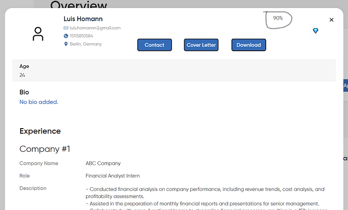

Thanks very much george, you are saving my day. The current user is the recruiter. The text value is the result of the matching between the candidates profile and the current job that the recruiter is viewing the application for. The result of the API is for the specific candidate the recruiter is currently viewing (The cv of the candidate to be precise). Currently, all the CV pop up contain the result of the analysed CV after the matching button has been clicked. What I want to do is to make sure the results are only shown for the specific candidate and/or reset the text value to 0 once the pop up is closed.

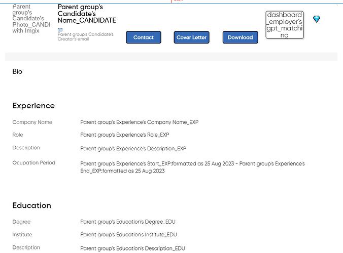

Here is a pic of the buidling side
Okay, so the API call takes the % of the first candidate popup that you open and doesn’t update if a different candidate is opened.
Put the text in a group (and make the datasource of the group the API call). When the popup is opened and after displaying the candidate in the popup, reset the API call group so that the API call refreshes with the new user. Pretty sure that should work.

I did it like this: Thanks to your advice of putting the group below the text I was able to show the element when the workflow is triggered and hide the element once the popup is closed, Like this the % number is only shown after clicking and therefore showing the right data. Thanks so much George you are the best!!!
