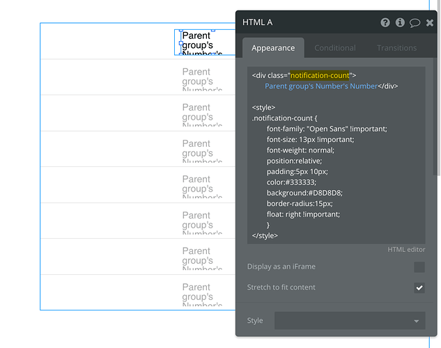

@nocodeventure You can use an HTML element for that; it is used in this AirDev example :slight_smile:
I can’t seem to find the part of the HTML which I need for my project as there is a long list of HTML text for css and fonts. Would hope someone can point out a specific solution.
@nocodeventure Here is an example :slight_smile: (I’m not 100% sure how AirDev created this originally, but this is how I’ve edited it in the past)
Preview:
Editor:

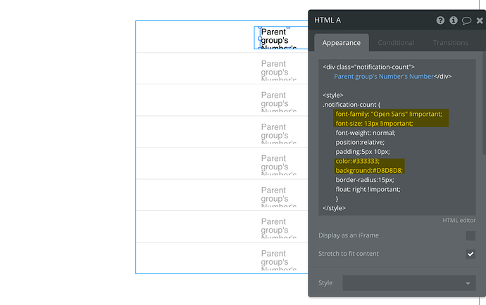

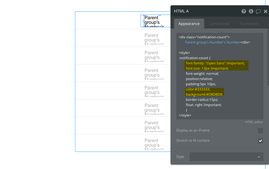

It looks like the HTML in the Page header in the AirDev example no longer modifies the HTML elements in the RG cell (might be a Bubble bug since that worked previously). For now, I put the code in the HTML element here:
In this element, the div is named “notification-count”:
And the styling for that is referenced in this part of the HTML:
I placed the HTML element in a group, incase you need to add a workflow when the notification count is clicked. I think that should work! :slight_smile:

I cleaned it up and everything works fine.
<div class="notification-count">
       Parent group's Organisation's Contacts:count</div>
<style>
.notification-count {
	font-family: "Open Sans" !important;
	font-size: 13px !important;
	font-weight: normal;
	position:relative;
	padding:5px 10px;
	color:#333333;
	background:#D8D8D8;
	border-radius:15px;
	float: right !important;
</style>
@nocodeventure The elements are not responsive in width themselves, but the HTML styling in this example creates that “chat Bubble” effect so the background color only stretches as far as the text. This works in a vertical RG, but would not look good if the elements were in a horizontal rg. If you were to place the elements side-by-side, the elements themselves would have the same width at all times (as defined in the editor), but the styling would make them look like bubbles. My thought was that it would be possible to create a plugin which accomplishes the chat bubble effect as well, to make it easier for Bubblers to add that element to an RG, modify the font, background color, size, etc. (Neither would have an actual responsive width, it would just have the chat Bubble effect.) My apologies for any confusion! :slight_smile:
