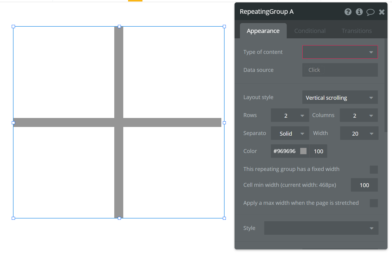

Hi @tzuork,
I just tested it and it’s working fine for me (see pic below):
So it sounds like it could be a bug if it’s happening even when you created a new app. Might be best to file a bug report.
Mine doesn’t look like that, I have to click Styles and click edit and create a new style to access Separato.
Strange!
I’ve just jumped on my PC and that was it! I had a style on, if I blanked the style the Separato setting shows. For some reason adding a new style WITH a separato, the width won’t work. I’ve removed the style, the setting you have shows and the width works!
Thanks all for the workarounds both, and thank you for the solution Adam!
