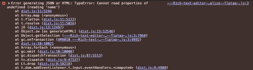

Hey Rico, thank you for adding the image resizing update. I was playing around with it today to test it out…
These errors are thrown up in the dev console since the image resizing update. Do you know what’s causing them/ if it’s related to the resizing issues?

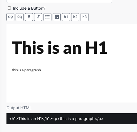

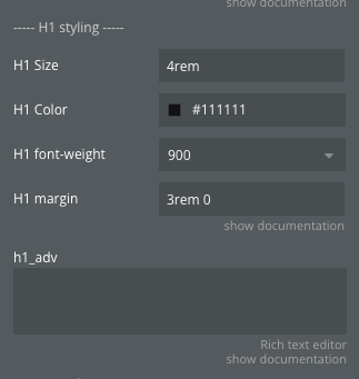

I have scoured this post but cannot find the answer to this and might be a noob question. I am using the Tiptap editor to create HTML to send emails. Essentially what I am wondering, is using find&replace what I am supposed to do to format TipTap’s Content (HTML) saved as a text in the database for emails?
  1. For example H1 has styles attached in the tiptap but when the HTML is saved there is only the <h1>This is an h1</h1> tag rather than <h1 style="size: 4rem; color:#111111; font-weight:900; margin 3rem 0">This is an h1</h1> should I be doing a find&replace for <h1> and replace with <h1 style="size: 4rem; color:#111111; font-weight:900; margin 3rem 0"> after the HTML is saved as as text thing in my database?
  1. When I hit enter in the tiptap, the HTML creates a new paragraph element rather than a <br> so right now I can find&replace<p></p> in the HTML and replace with <br> but is clunky for a user when they paste some text with paragraphs in it because it looks like each line should have a <br> but it is a new <p> which means the resulting HTML will not have an empty row between each paragraph but in the tiptap it looks like it should (not WYSIWYG). So should I find </p><p> and replace with </p><br><p> when saving the HTML to create an actual new line? Am I doing this right or does someone have a better way?
