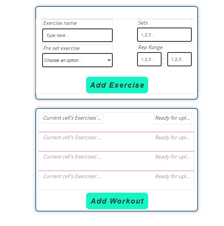

So I have trainers within my app that create workouts for clients and I would like to give them the option to create a workout library with and list of exercises that have links attached to each exercise.
From there, the trainer makes a workout and can pick from a dropdown menu a exercise (they created with link) to add to the workout.
When the clients views their workout, they can then click on the exercise name and a popup will appear showing the YouTube video that the trainer attached to that exercise.

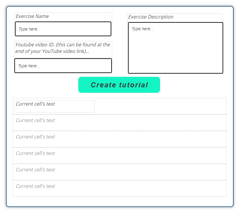

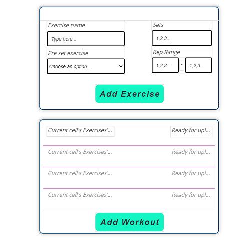

The trainer creates the exercise (text field: exercise name) (text field: YouTube link) of one page that are stored in the database for future use.
The trainer then creates workout and from a dropdown they can select any of the stored exercise in the database. They can reuse exercises to make up multiple different workouts that are saved in the database to be sent out to multiple different clients.

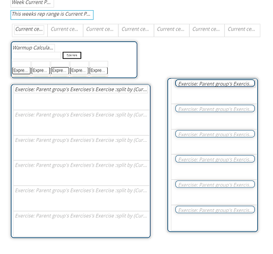

On the clients end (client profile) they have a workout page where the exercises within the workout (that the trainer has assigned to them) will be displayed. When the client clicks on the “exercise name” the popup will show up with the video.
This is the client workout page (still not finished looking pretty). When the client click on “Exercise: Parent group’s Exercise’s Exercise :split by” (which shows the exercise name) it will show the video in the popup.
Sorry but I’m a little bit confused. Can you share a link to your app? If not, create a dummy app that replicates this functionality that you’ve built and share that and then I can take a look.
