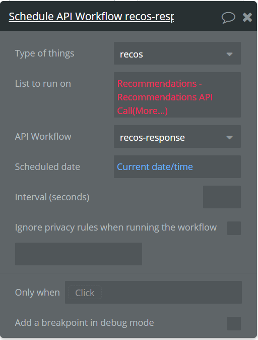

I am trying to get my API workflow to run on an API call which returns a list and then save each element of that list to my DB but I think my problem is that the list to run on doesn’t match the type of thing?

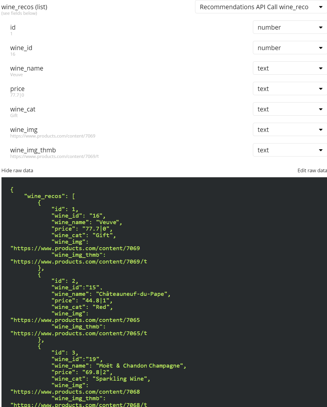

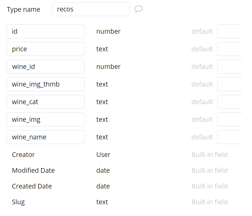

Recos is built out like this:
And the api response is built out like this:
Everything looks to be paired up properly but my guess is there is something more subtle I’m missing with the way the api needs to be set up in order to work

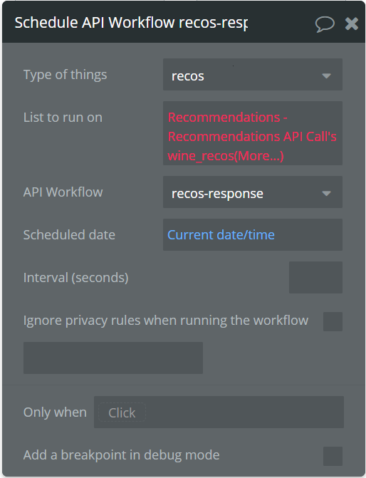

Also, I have tried adding in the “wine_recos” to the “list to run on” field but still the same:
Thanks in advance
When you do a API call I think the type changes (It’s what I see in my app) - so the type of thing is probably at the bottom of that “type of things list” called
Recommendations - recos
maybe. :thinking:
Thats it!!! Thank you so much! I knew it was going to be something simple.

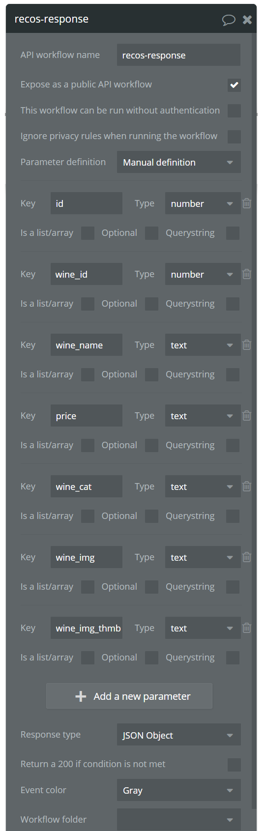

Here is my workflow
And here is my backend workflow

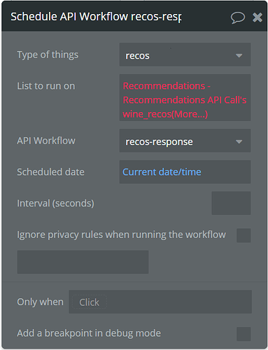

So, I went back in and found that it didn’t actually stop at 1062 records, it kept going to 1,400 which is exactly 7 x 200 and 200 is the number of recommendations I have and 7 is the number of attributes per recommendation. So I think the “list to run on” is running on each attribute as opposed to each recommendation. Any idea how to solve this?
