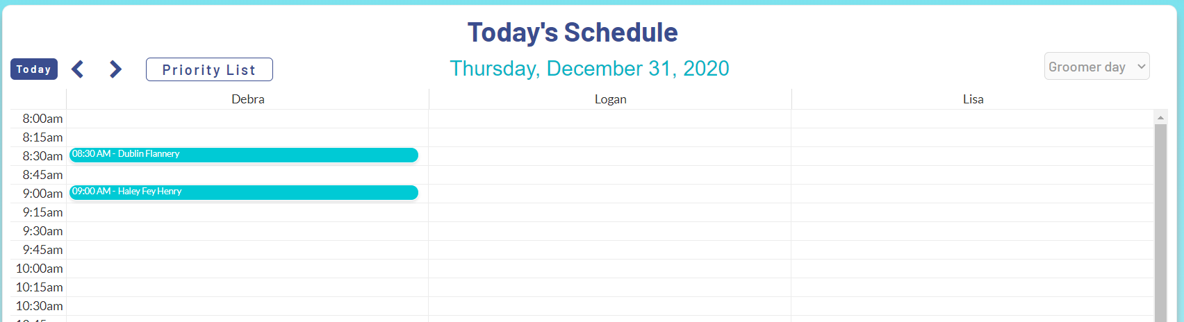

So how mine is set up, there is a main screen that a superviser uses that sees all employees and schedules. I actually use Air Calendar because it has quite a few views with “Resources”, so in my database the employee is the resource, so it looks like this;
So when an appointment is made, they see the same calendar (or have a drop down) of a list of Groomers and Bathers (all employees). So when the appointment is saved, that Employee is saved into the appointment.
When a Groomer logs in, they are taken to their dashboard which has the same exact calendar, only the resource is just Current user, so it’s scanning the GroomingAppointments but only displaying the appointments where the groomer=current user. That way they only see things assigned to them.
