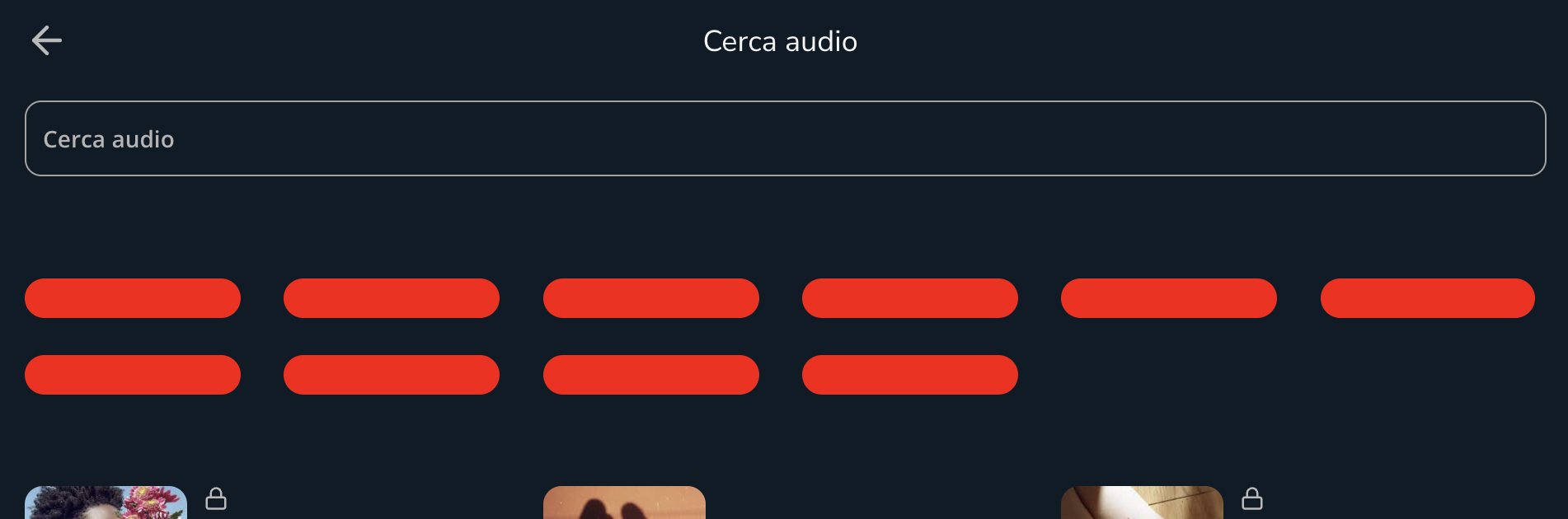

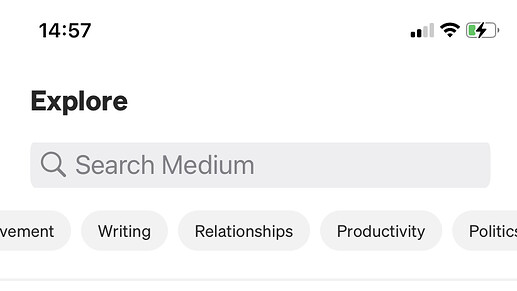

I am trying to build a search like the one below.
The data types have several tags. The filtering should be done with those tags by clicking on the relative word underneath the search bar.
Thanks for help.

One way of going about this would be to set a state corresponding to the tag when it is clicked, and have the result display group to be filtered by the value of the state.
Step 1/ Create a custom state, let’s call it « Search tag », set it to either text or refer to an option set if your tags are stored that way in your data type.
Step 2/ Create an on click workflow
When the button in the horizontal repeating group is clicked, set the Search Tag’s state to that value.
Step 3/ Configure the filter in the repeating group that displays the results.
Data source : do a search for : Data Type : filtered : item’s tag IS current Search Tag state.
:warning: my answer is generic and you may have to make adjustments in function of whether the tag type is text value or option set derived.
:warning: if the results displayed come from a huge list in your database (>200 items for that data type) you should consider creating a satellite data type to display your tag repeating group (the one used to filter). This data type would contain only those tags, this way page loading time is minimised. This can be achieved with a database trigger event. I can go into more detail with respect to this if you think this might be an issue.

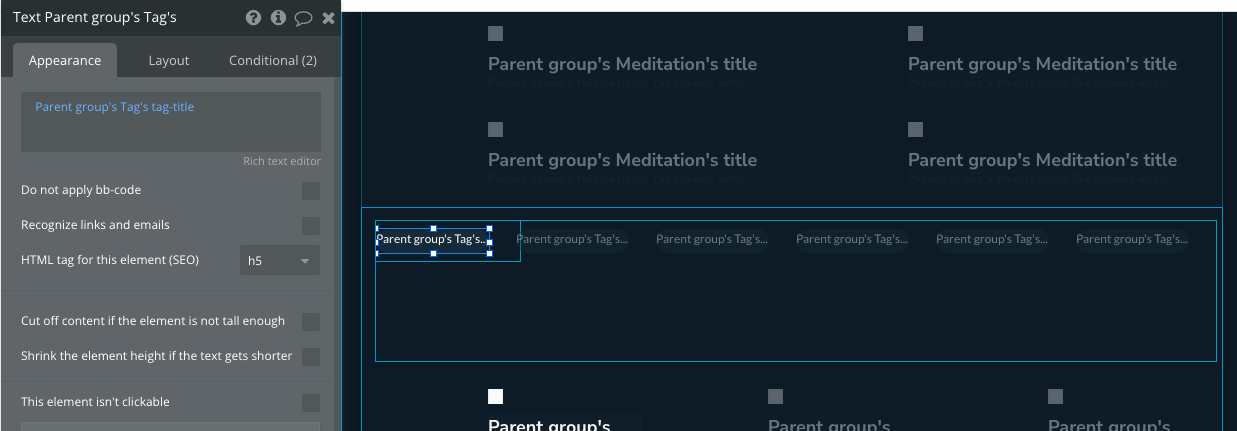

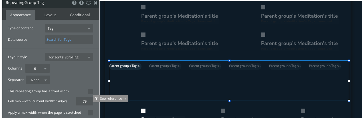

Maybe you can help me on the layout as well: how can I get rid of that ordered column/row setup?
Not like this:
More something like this:
I cannot find the way to have the text width adapting to text length
Also vertical centering seems a real challenge
Screenshot 2022-11-21 at 23.12.28
Thanks!

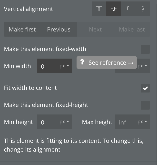

On your repeating group do “Wrapped horizontally” for the layout. Then make sure your text width fits to content, and your group also fits to the text.

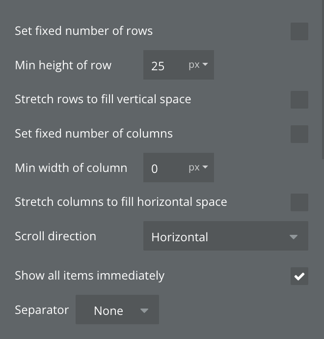

Hi there again,
Sorry for my late reply and sorry to hear you are struggling with this issue. Bubble can be frustrating sometimes but no worries :slight_smile:
Here is how I would go about our tag situation:

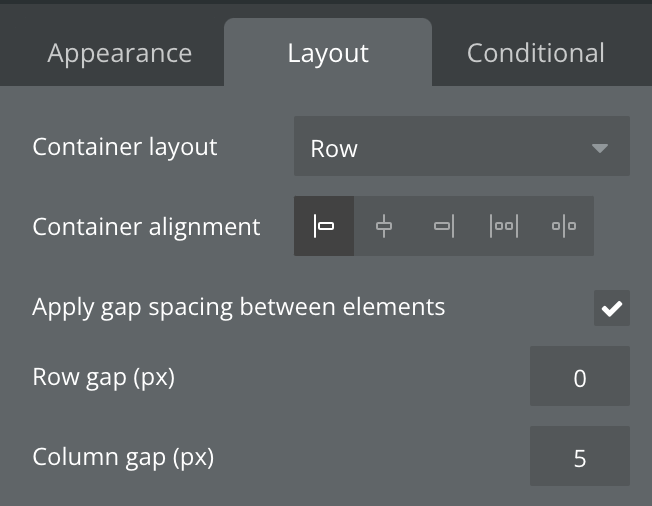

1) Configuration of your repeating group:
a. Layout
b. Row and column configuration

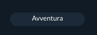

2) Configuring your tags:
At this level, apply generous padding. I typically go for:
Top: 5px
Bottom: 5px
Left: 10px
Right: 10px

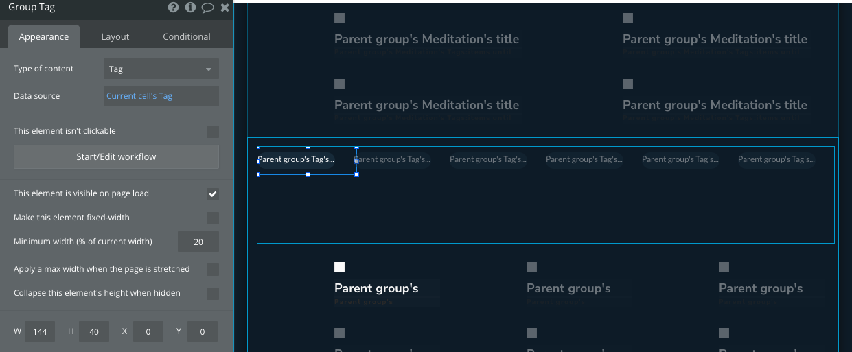

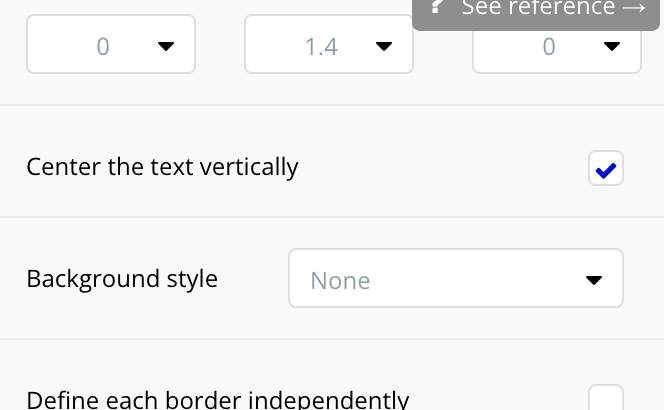

In order to get your vertical alignment centered: two things:
  • At the text box level: :white_check_mark: center text vertically
    Capture d’écran 2022-11-22 à 14.22.40

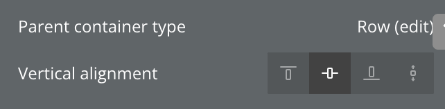

  • Every group within your repeating group should have a centered vertical alignment as follows:
    Capture d’écran 2022-11-22 à 14.24.38
Hope this helped.
Regards,
Cynthia
