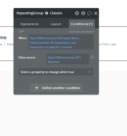

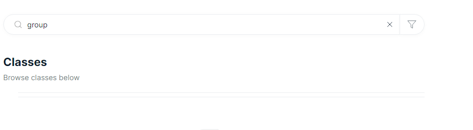

I use Fuzzy search with search input. And when my page is loaded in the beginning I have default data. When I enter something in search input, the correspondent results are displayed. But when I click on clear button in the search input, the last result keeps. In this case I want to show all items (default state).
What the problem can be?
Are you using the ‘Reset Relevant Input Action’ to clear your input field? With the Fuzzy Search & Autocomplete plugin, you should specifically use the action called ‘Reset Input A Search & Autocorrect’. This will properly reset the input if you’re also using the ‘Set Text to Match from an Input Box’ feature.
