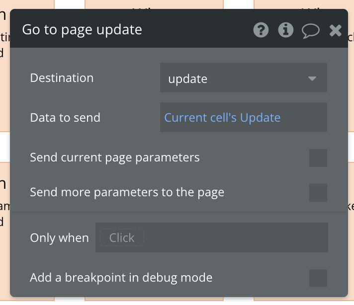

So I have my dashboard page. Inside, I have a RG listing what is called Updates.
When I click on a row, like “secondUpdate” for example, it leads to the page of the update.
My issue here is that the Update’s data is not sent to this page. The “secondUpdate” item has a name, a title, a body but the information is not pre-filled.
In the workflow, I have setup the following for “click on Update Row”.
What I am missing for the data to pre-fill the Update page?
Thank you.

Ok I found it epxlaining… I missed one thing obvious indeed…
I forgot to setup the data source of the main Container (another one from screenshots)
Damn, thanks for your help
I had checked the debugger but nothing was displayed. Anyway, it’s solved thanks to your indication, I dig and it was very helpful!
