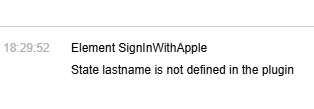

I’m getting the below error whenever I try to signup (first time):
However, prior to that step, you can see that Apple returns both names and email on first signup:
Then in the debugger- you can see that the email and first name are getting passed through fine - only the last name is empty:
Looks like the definition for “lastname” was removed somehow? Is anyone else seeing this? It’s just the last name that’t not working.

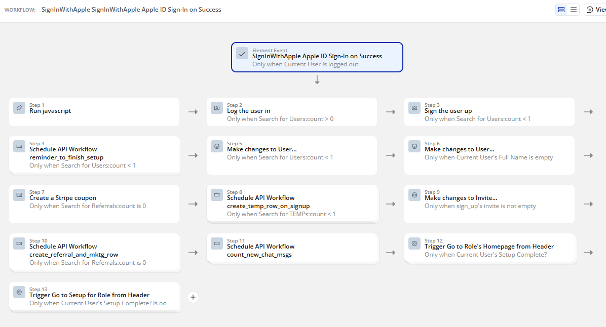

Sure -
plugin settings:
UI Element:
Associated Workflow:
“Sign the user up” step
And when you step through the process, you can see below that the error is thrown after the user logs into their Apple account but before the “SigninwithApple sign-on success” gets called:
Here is the error again:
Stepping further into the workflow you can see that the sign the user up is called as it’s the first time logging in for this account:
and here you can see in the debugger that while the first name and email are provided, the last name is not:
and here is the corresponding workflow step from above in Bubble:
Please let me know if you need any more info, thank you.
