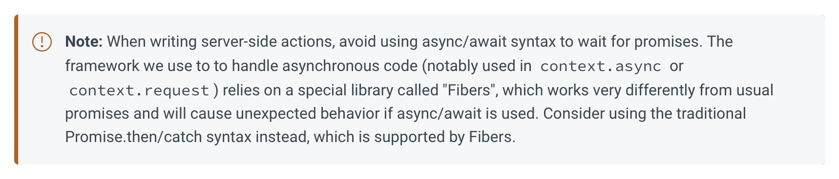

Yet another interesting project popping up recently on the forums. The library they are using that wraps this functionality has been discussed somewhere. I’ll take a look for where I read about it in detail. Maybe someone like @vini_brito will chime in before I get back.
Ahh found it: Building Actions - Bubble Docs
I think you might have better luck if you try to reproduce this functionality using the “Fibers” library. It’s not likely to happen anytime soon but one day maybe Bubble will move away from this and uses standard node async/promise functionality.
