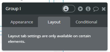

I have bought your template because It is very complete and neat.
However, I’ve encountered some limitations while trying to use the template. Every element within the template appears to be locked, rendering the layout tab inaccessible. This has imposed restrictions on my ability to utilize this resource.

FYI… the user you tagged hasn’t been seen in the forum since April, and their profile says they are the ex-CTO of Skillum. So, just saying if it was me, I wouldn’t hold my breath for a reply from them here in the forum.
Oh, and I’m not sure, but I think that message might be related to the template being on the old responsive engine. If that is the case, you might consider upgrading the page the element is on, and you would definitely want to make a copy of the page if you do that.
Thank you @mikeloc,
By upgrading to responsive engine, It works fine !
