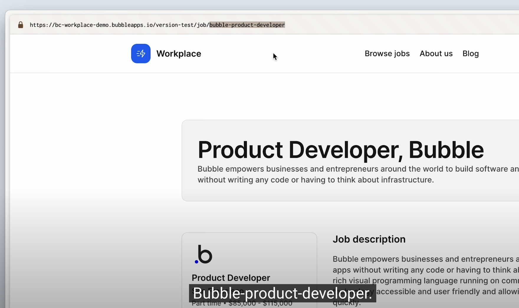

Hi everyone, I am following Bubble’s tutorials (YouTube video: Job page: Getting started with Bubble (Lesson 5.7)) and seemed to have missed how to add a slug for the job page when clicking the job link from the search page.
I am aware we can create a workflow to a button and set slug from there. However, how did they do this from a URL link going to the job page?

I am still learning through these Bubble instructional videos and believe the instructor in the video didn’t go through it yet in the beginning of the video he says it is auto-generated.
