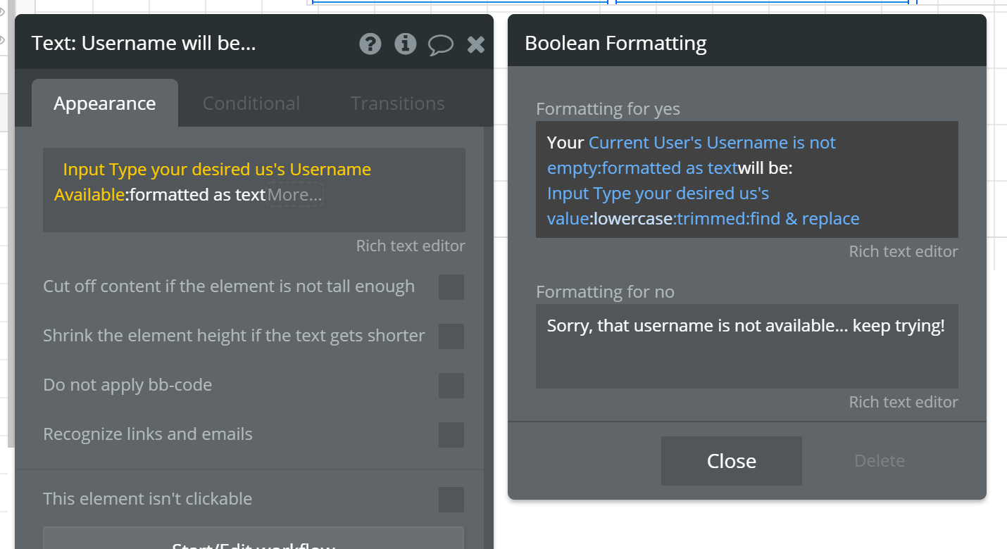

How would you make a case insensitive search for username?

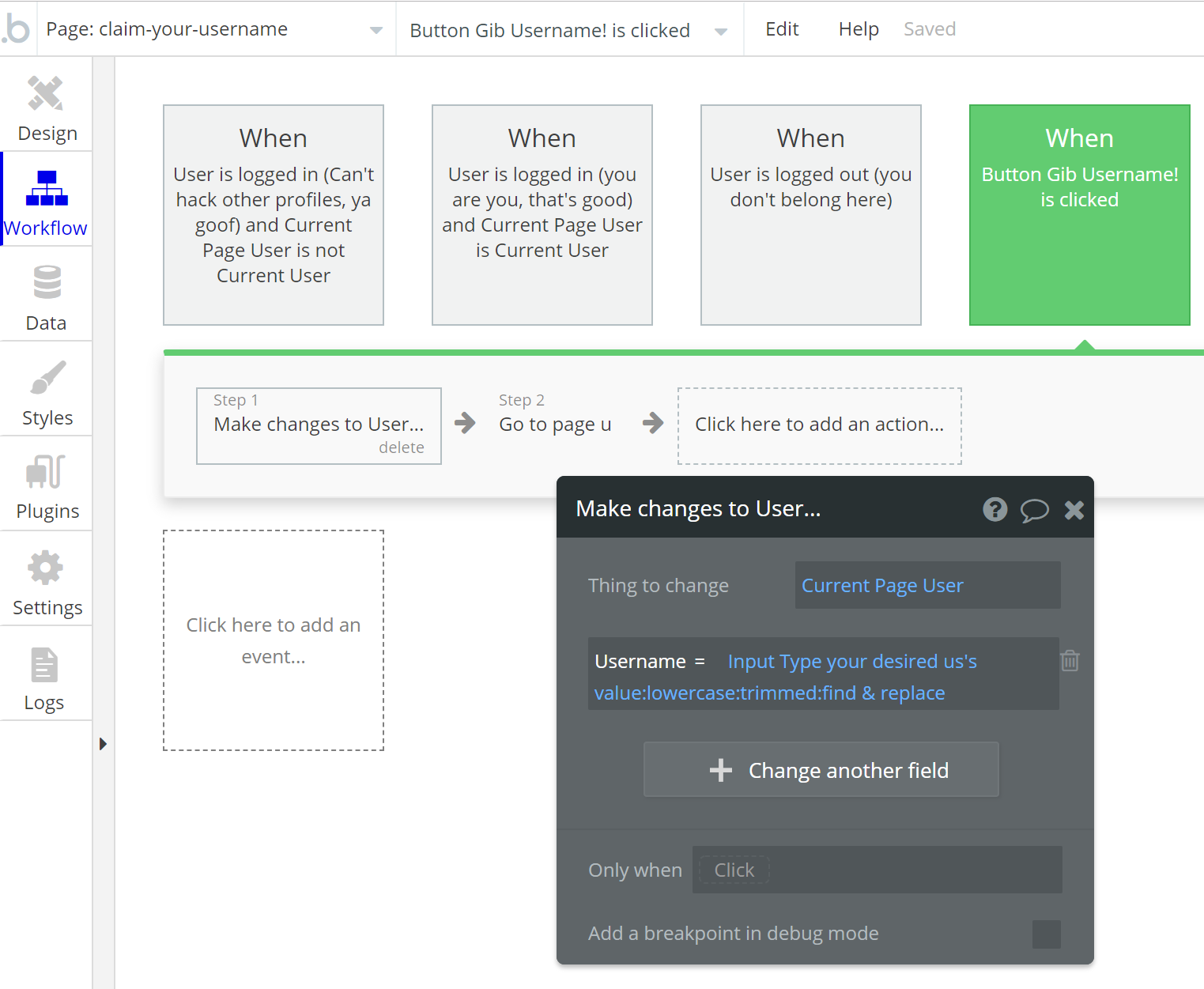

So, to ignore case in a search (which I guess would actually make sense in my example – there can only be 1 “beau”, so we might as well return “beau” if someone tries “Beau”, “bEau”, “BEAU”, etc.) you just convert both your search token and targets to lowercase and compare them that way.

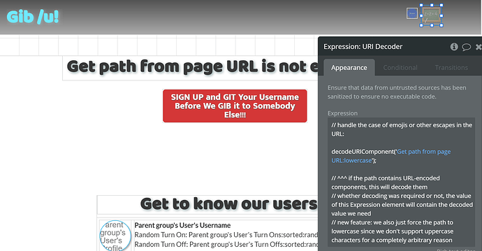

I just went ahead and did that. In gibu, this means changing our URI Decoder Expression element to force lowercase (our search targets in the database already ARE lowercase):
(We don’t have to change our Do a Search… expressions around the app since they all just look to this Expression element’s value for the criteria. That was a bit of foresight, eh?)
Now, if you database WAS full of usernames with mixed Latin cases, you’d have to modify your Searches to use the Advanced filter criteria so that you could operate on them. Like this:
^^^ this is fake, OK? the last part isn’t a real thing, I’m just trying to get the idea across. You take the acquire the search string from an input or somewhere and then you :lowercase it. You may or may not be able to do that directly here in this dialog without using the “my search token is not empty:formatted as text” trick to get you to a full-fledged text expression builder.

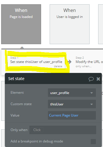

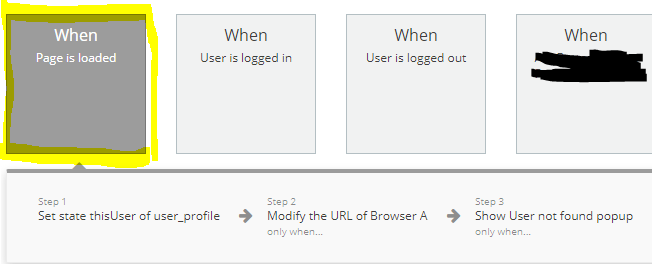

Also instead of doing “do when condition is true” workflow, I’ve changed it to trigger “on page load”.
Birds eye view of workflow:
screenshot1

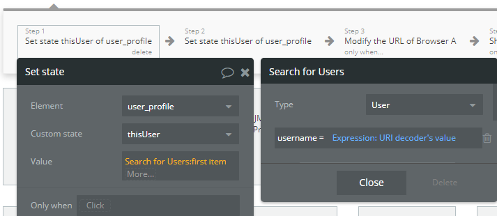

Here is where it sets the state “thisUser” of pagename “user_profile”

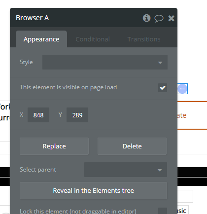

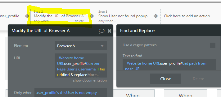

Here I am modifying the URL

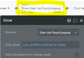

Here is a popup to show user is not found

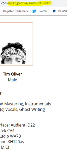

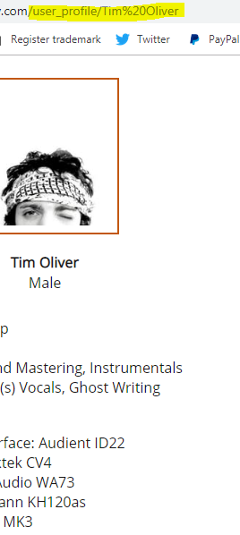

Now this is what I’m experiencing on the browser side of things. In this example the user name is “Tim Oliver”. If I click the “view profile” button to be taken to this users page, from a logged in users page, this is what the URL appears as
As you can see above, the username has a space in it, the the space is given “%20”. You can also see that the page populates all the relevant data for that user.
Now lets see what happens when I refresh the page from here
The above result is actually the identical result I get if I attempt to just type the URL in my browser, simulating being a person who is not a signed up member of the site. So, all-in-all it isn’t working.

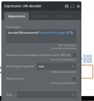

Alternatively, you know that %20 in your URL? THAT’S A URL ENCODED VALUE.
So, you say you don’t need the Emoji support crap… BUT YOU DO. You need to get that %20 out of the URI to do your lookup properly. There IS no user named “Tim%20Oliver”.
In fact, you could go make him right now!
So you need to URI decode that so that your search for users is looking for “Tim Oliver”.
See?
@keith,
Here I have added the “emoji” decoder because I can definitely see your point. I placed result type as “text” which I hope is correct. I’ve also made sure it’s a capital “uri”, not “url”. I did try both because I wasn’t sure at first which one it was.
