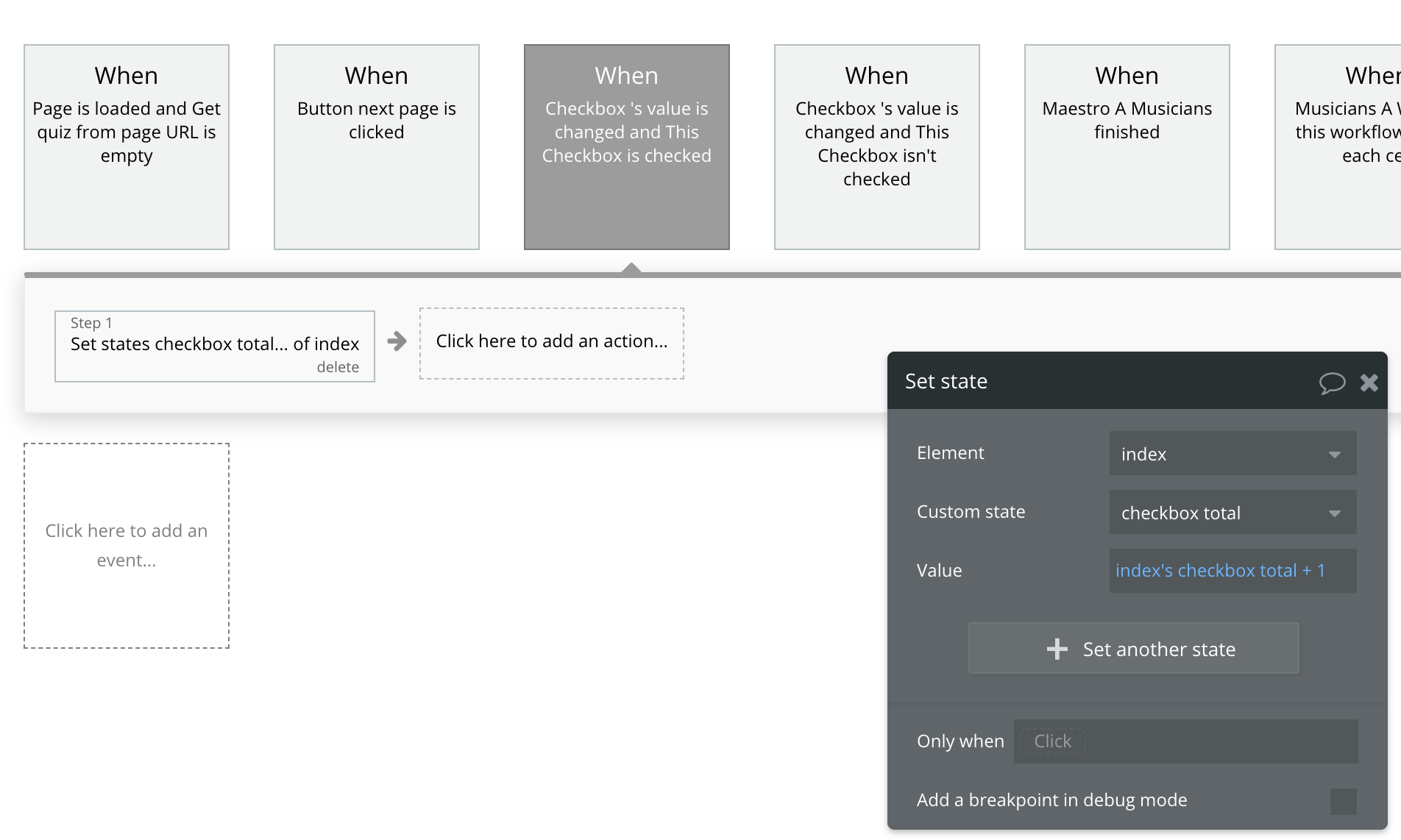

I ended up taking a different approach to solve this issue.

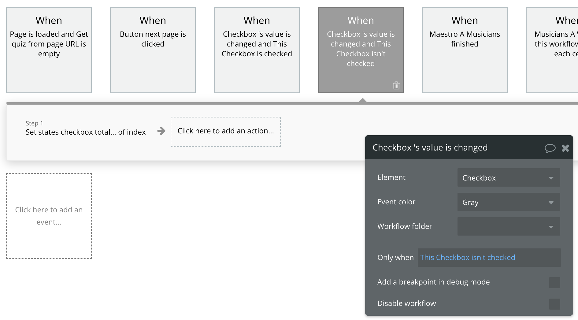

Instead of updating the total score during each round of the Orchestra plugin through the RG based on the value of the checkbox. i added these two workflows to change the value of total score immediately went any checkbox is checked or unchecked.
I also got away from several pages and put it all 3 quizzes into one page using page URL parameters to do some of the magic.
