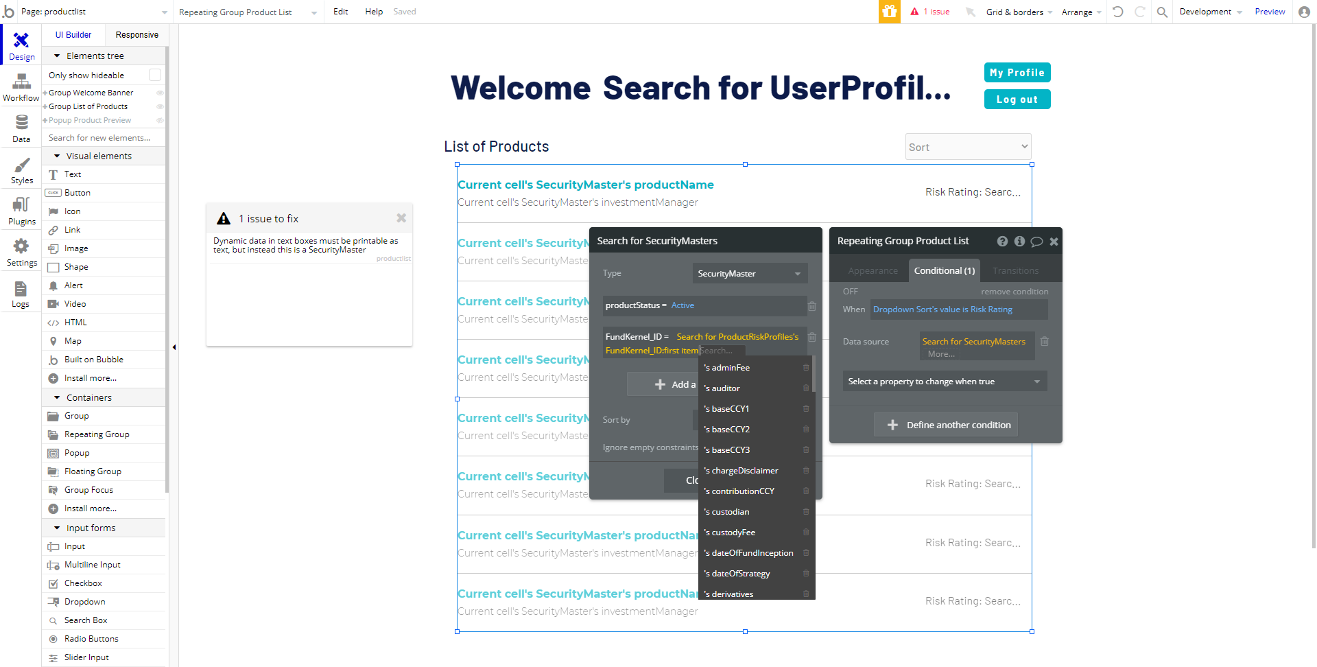

Hoping for some guidance. Below is the screenshot.
I’ve set up a Repeating Group of products below.
Most of the data displayed in the repeating group come from data set “Security Master”, hence I’ve configured the “Type of content” of the repeating group to "Security. However, I do have the “Risk Rating” coming from a different data set called “Product Risk Profile”. Both data sets have a shared data object called “FundKernel_ID”.
Now, I want to create a sort the reporting group based on Risk Rating but I can’t seem to get it correct. Here’s what I’ve done…

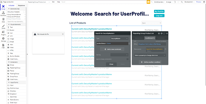

First, I’ve set a condition for the repeating group for when the drop down value is Risk Rating and do a Data Source search for Securities Master. A constraint is set up to make sure the product listed are “Active”. So far, so good.
But that doesn’t really sort the Risk Rating. So I thought I would add another constraint that would associate the Security Master with the Risk Rating by identifying their “FundKernel_ID” data object. When I tried to do that, it gave me an error.
What am I doing wrong? Can someone offer up some advice?

If you hover over the expression it will tell you to what it’s evaluating. The constraint FundKernel_ID = needs to evaluate to 1 single FundKernel_ID
The expression search for ProductRiskProfile's FundKernel_ID:first item is probably evaluating to a list of FundKernel_IDs. Because the first part of your search is evaluating to a list of ProductRiskProfiles. You probably need a :first item after the first expression.
In any case, I don’t think that’s what you’re trying to accomplish.
My rough guess on the sorting is that you could achieve it by adding a :sorted to the end of the expression. But that will do the sorting on the client side. If your search returns a lot of items (~>200) it might slow down the user’s browser.
Could you add the sort field to the data type? That way you could select it from the Sort by on the search.

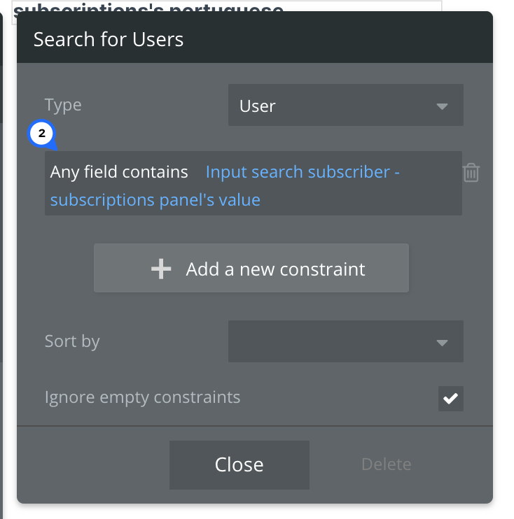

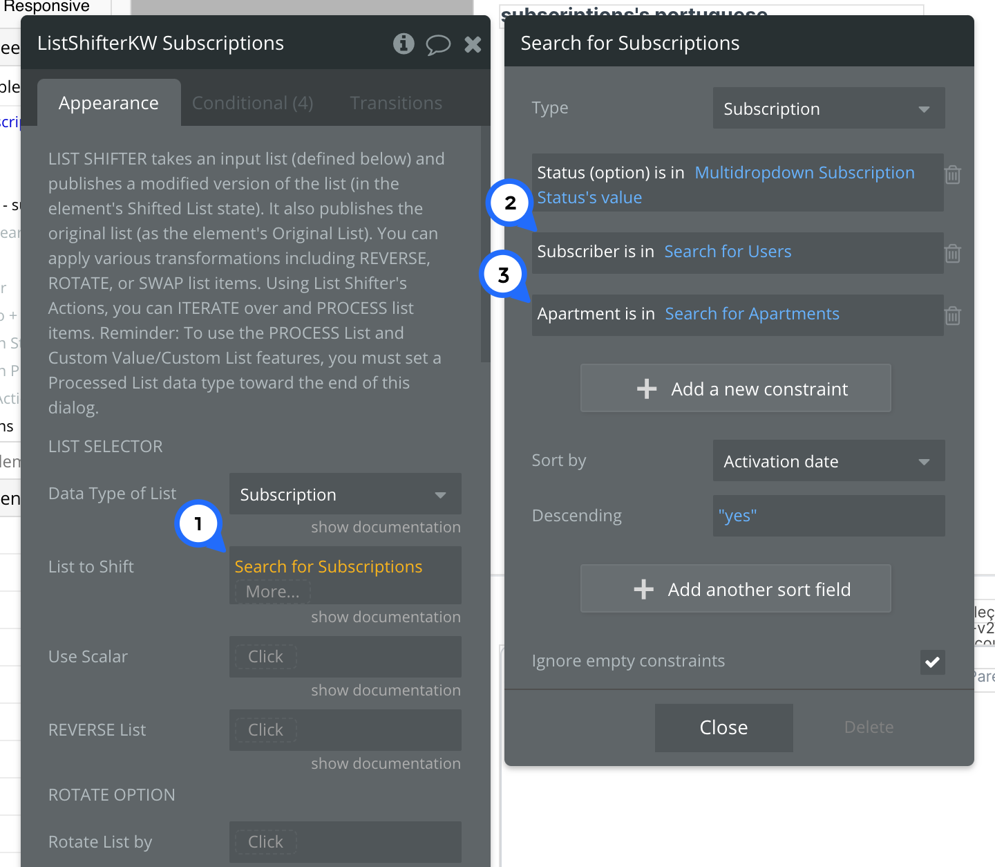

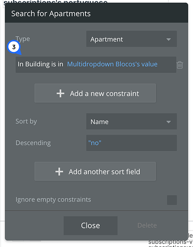

Maybe that equal signs needs to be is in instead. Here’s one of my app’s search expression, I’m wondering if this could be of any help:
Detail of constraint 2:
Details of constraint 3 - the Multidropdown that it’s referring to has as content a list of Buildings.
