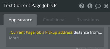

OK, I think I can select ‘distance from’ option, my problem was the post code was not of type geographical address, so the ‘distance from’ option was not showing
Hi, I am trying to do a similar thing. But I can’t find out how to use the ‘distance from’ function.
I can see how to get the first data point, using something like this:
35
I want to use a list of Drivers (I think I would need to do a Search for …)
Can you give me an example of how you did it please?
Use the complete syntax, address 's value then the distance from would work
