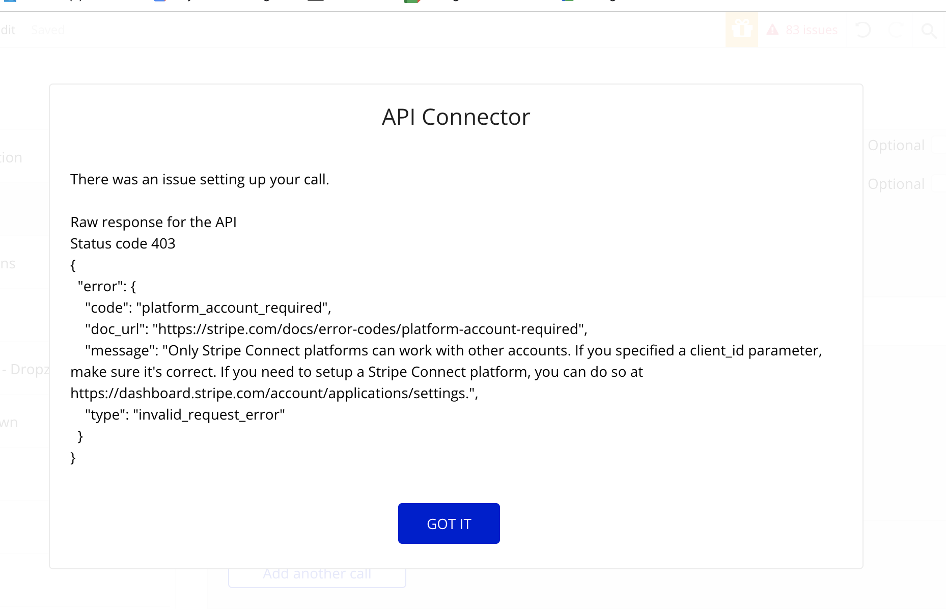

i was, i tried a different account to test and now been given this error

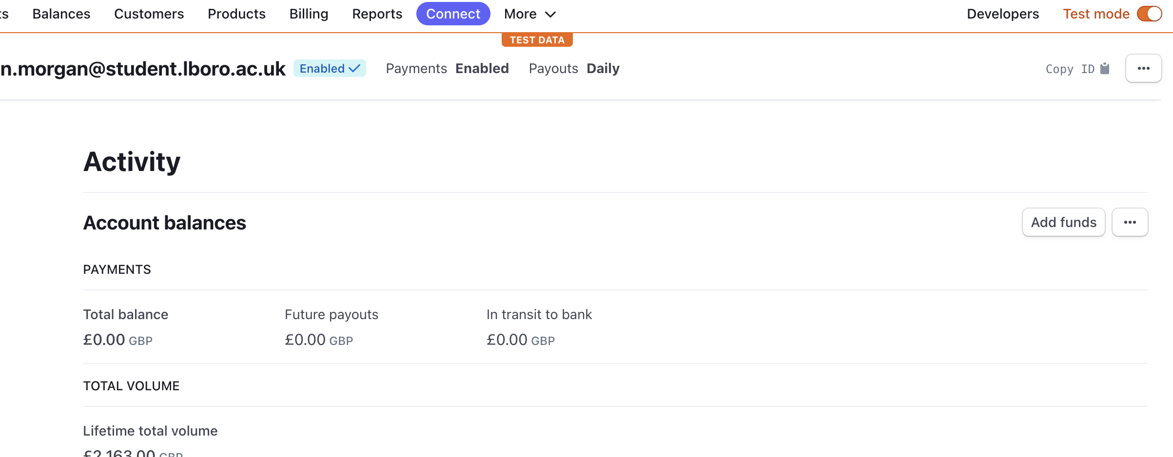

is that account connected to the platform?
yes! it is
That’s strange.
As you can see in the docs that error means that you are not making the request as a Stripe Connect platform.

Its weird as it makes the call on postman
try adding the header content-type set to application/x-www-form-urlencoded (in the request, not in the shared headers) and see if it works.
