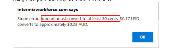

Stripe APIs have been set up correctly and currently using V2. However, branded popup doesn’t show on platform even though branded version created in Stripe and also this error message appears. Does anyone have any thoughts on how this can be rectified? Currently using Zeroqode and they are unable to resolve.
Seems like you have to have a charge of at least 50 cents for a transaction. Are you trying to charge .17 cents or .23 AUD on purpose? Perhaps you meant to not convert it to cents?

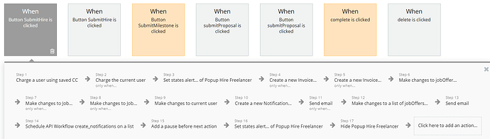

Can you post a screenshot of the transaction workflow step ?
Took me a while to find it
Yeah sorry this doesn’t help much without seeing the exact numbers being used.
I would suggest previewing your app, making sure the debugger is on, clicking step-by-step, and walking through the workflows to see if all the data/numbers are passing through as expected.
For every step, click at the bottom of the debugger to evaluate what the data is.
The popup alert that was shown says you were trying to charge .17 cents, which is not allowed by Stripe. Somewhere in your equation up top its making the charge .17 cents as opposed to what you’d need it to be.

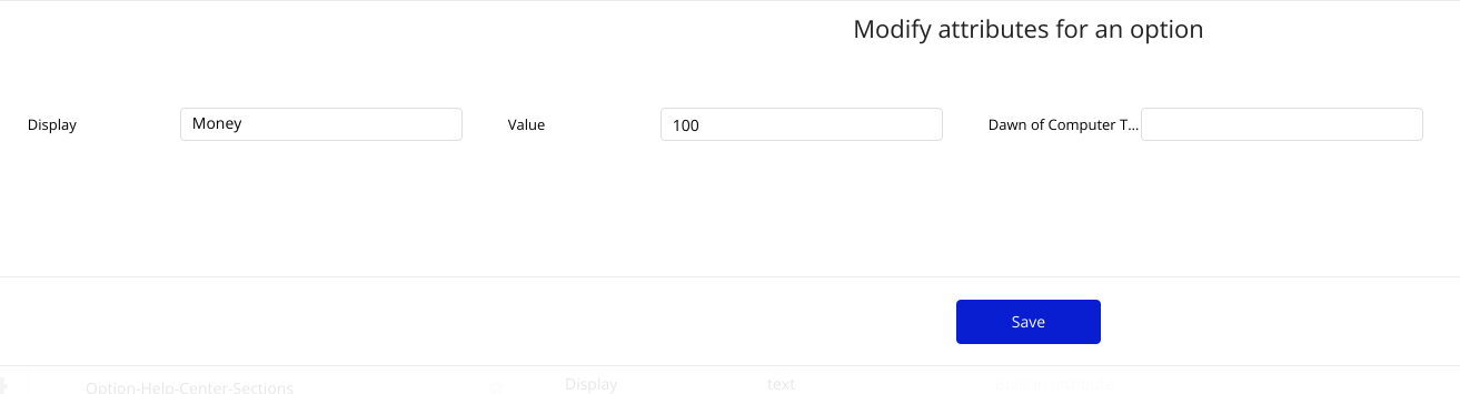

Other thing that is incorrect about this in my view is the need to do a search for a ‘variable’ that is the platform fee. That platform fee percent should be an option set in my view as you don’t need to perform a search and a platform fee is definitely not something the user would be creating and instead would be set by the Platform Owner.
Another issue that might be happening is that the conversion from numbers in your bubble app to an integer accepted by Stripe is not happening.
Stripe needs it as cents, Bubble saves it as number.
Bubble DB entry is saved as 10 which is equal to $10
Stripe needs it to be 10*100 to be 1,000 cents

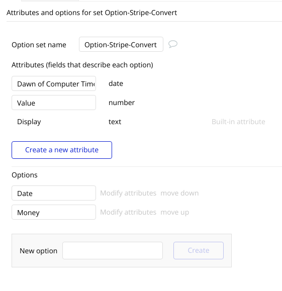

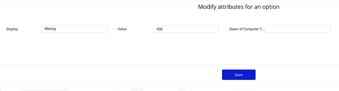

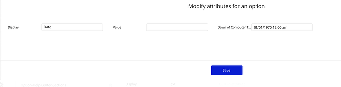

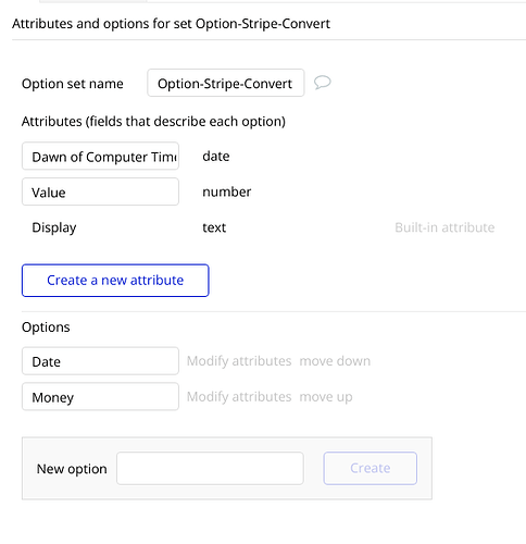

The proper approach for considering this fact is again an option set that you can easily call on to help with the math for conversion. I do this in my apps.
Money is to convert prices to cents and to convert cents back to dollars. Date is to convert date numbers from Stripe (seconds) into date values for Bubble (milliseconds). Conversions like this are necessary to ensure proper charges applied but for the date to enable pagination and sorting based on date and displaying it to your user in their timezone.

As we can see from the error, which you have shared at the beginning of this thread, the error is related to the amount you trying to convert:
The pop-up alert says you were trying to charge 0.17 $, however, it is not allowed by Stripe (this amount is too small).
So, you should convert at least 0.50$ ( or its equivalent).
