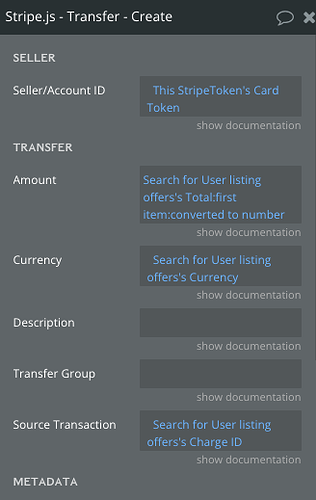

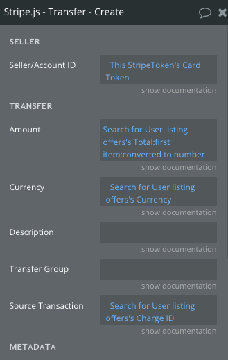

As a seller when creating withdraw, i created consumer and convert token again, then when seller is current ID and token is created | Create transfer with a source transaction that created by the charge token on the first place.
The problem is that stripe does not show any transfer logs, what i am missing here?

Transfers are reserved for transferring money to linked accounts with your account (you have to make a post request to link an account to yours and then you can see the linked accounts in your dashboard). Creating a card token will create card_… but an account ID starts with acct_… (if you click "show documentation) underneath the Seller/Account ID input field you will see)
What you are doing will not work. From what you’re trying to do, it doesn’t look like transfer is what you want.

4- transfer is like instant withdraw? or payout? which action do i need to use to make the withdraw work? it looks that something with the destination is not right.

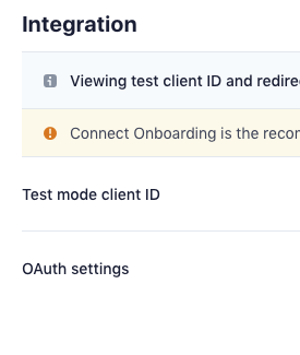

5- Creating onboarding link is working if this is related to destinations links issues, and i do not understand what is used for
