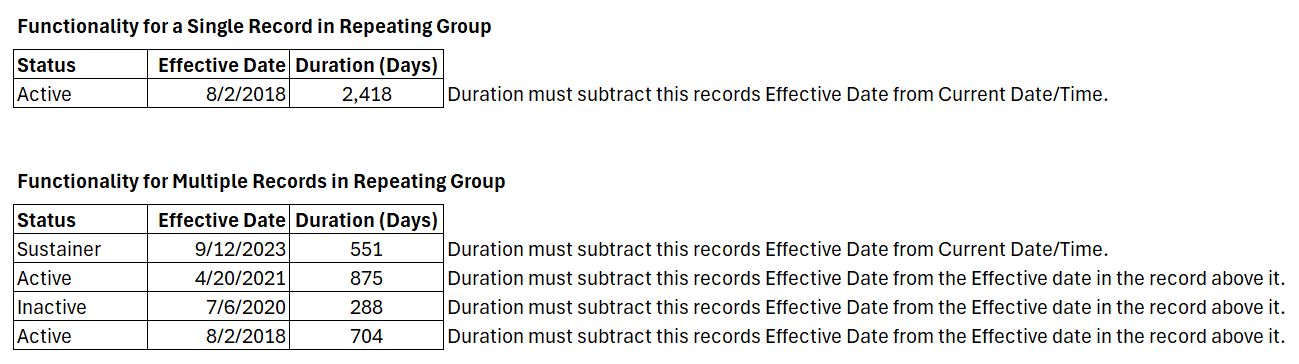

Simply having Current date/time - current cell’s effective date will not work. I have included an example of what I am trying to accomplish.
When a single item is in the RG, the Effective Date must be subtracted from Current date/time.
Once additional records are added, each Effective Date is subtracted from the one after it.
Does this help clarify the issue a little better?
Put two conditions on the days text for the duration:
  • When RG items count is 1 - substract effective date from current date time
  • When RG items count is > 1 - substract effective date from the RG item # current row’s index +1’s effective date
