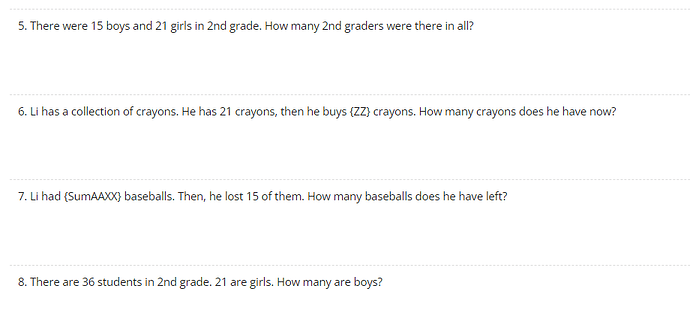

In my app data, I have three columns: {X}, {Y}, and {Sum}. {X} and {Y} have numbers 1-100. {Sum} is blank.
On the front end, I have a repeating group that displays randomized questions. I need the following rules to be true:
Sum < 100
Y > X
X + Y = Sum
Sum - Y = X
So, in question #2, the following should be true: 29 + 51 = 80, but as you can see, the sum is coming to 2. I believe this is because my {Sum} in Screenshot #2 is pulling new random numbers for {X} and {Y}, not the random numbers generated for {X} and {Y} in the question.
How can I take the random numbers in each question and find the sum?
I hope this makes sense. Thanks in advance for your advice!
