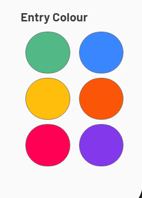

I want to make it so that as soon as the user clicks on one of these:

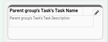

The border of the task/entry also changes with it:
Like this:
Here’s the conditions I have on the task/entry:

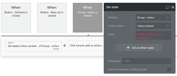

On colour click, you could probably set a custom state somewhere with the relevant color as its value.
And then if that custom state is not empty, set border color-top’s value to that custom state rather than task’s colour from the DB.
Great suggestion - I see how it might work but I’m running into an error:
I can’t seem to get the value to turn blue.
Hovering over the word ‘hex’ in that expressions says evaluate to text though.

Have you set the custom state type to text?
I’ve set it to the group in the repeating group which show the colors.

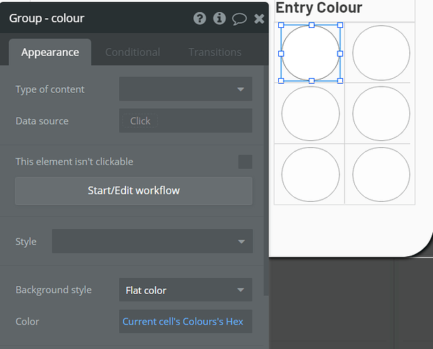

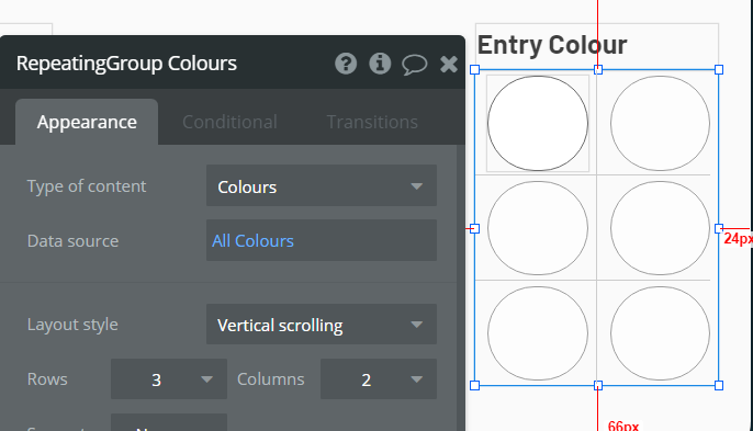

I’m not sure what you might be looking for specifically, but essentially, there’s a drag/drop area with a RG in it, inside that RG there’s a draggable group which is the task/entry.
Then when the edit icon (pen) is clicked, the pop up where you can change the colour comes up.
There’s a group with 6 colours based from an option set where the attribute is a hex code.
@alasadi.m1738 Try to set the custom state on RepeatingGroup Colours or some other element that can be referenced from Draggable Task (entry) and set the data type of that custom state to the Colours option set. You can name it ex. “selectedColour”. Then from the conditional tab, in border color - top get it like “element’s selectedColour’s hex”.
