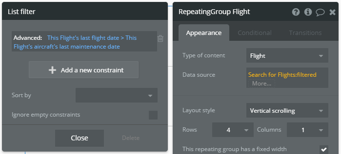

Hi there, @mrdbetts… after thinking about it for a bit and building out a quick example, the only way I can get to the desired result is to use an advanced filter.
While that filter works like a charm, it’s not going to be great from a performance perspective because the system will have to return all flights to the browser and then filter them on the client side. I tried storing an aircraft’s last maintenance date in the Flight data type itself, but I am still not able to get the desired result by using only constraints on the search for flights.
Anyway, I might be missing something simple, and I will probably keep playing around with it for a bit, but I didn’t think it could hurt to throw the advanced filter option out there.

… I used the advanced filter. The page is only looked at say once a month so a delay is acceptable. I also limited the search based on flight date > earliest maintenance date so only a subset of flights is being returned to the browser …
