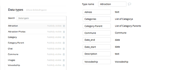

Database contains 3 main datatypes:

can you send a screenshot of your datasource for the dropdown vivo?.
Also send a screenshot of your database structure
I assume the datatype has a datafield called voivodeship and you related it to another datatype called voivo right?

yes, this is the dropdown voivo:
and databse structure
