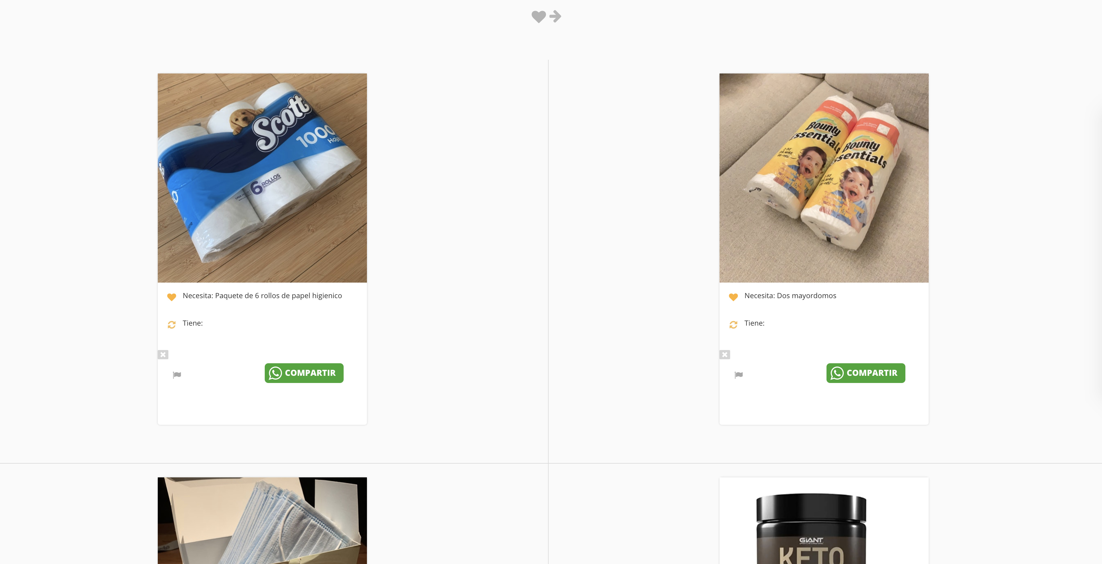

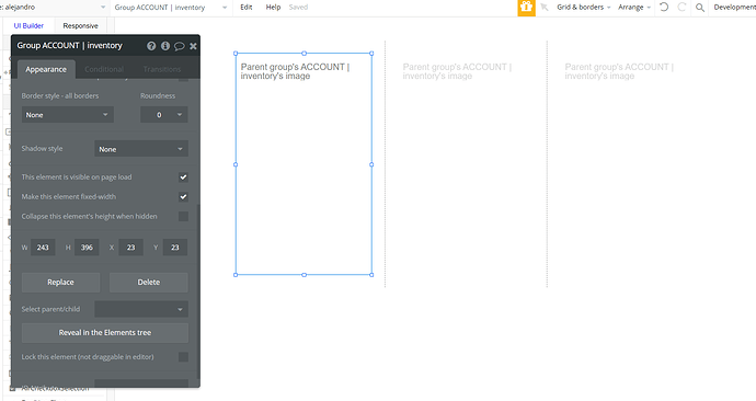

In the designer, it appears to work, but when I preview it, it displays as just 2 columns. Here’s my settings:
But when I preview:
Help would be much appreciated!
in the main repeating group. cell min width is 0 now. set it to be the min which is 399 or even less and try.
better to group Main Repeating group so you have MAIN group inside it there is RG then cell group.

Adding a minimum width doesn’t seem to do any difference. Still only shows 2 cells and in designer mode it shows 3.

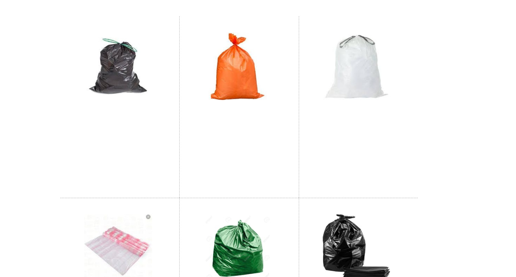

This setting works for me simple. make sure the Cell Group inside RG is centered.
