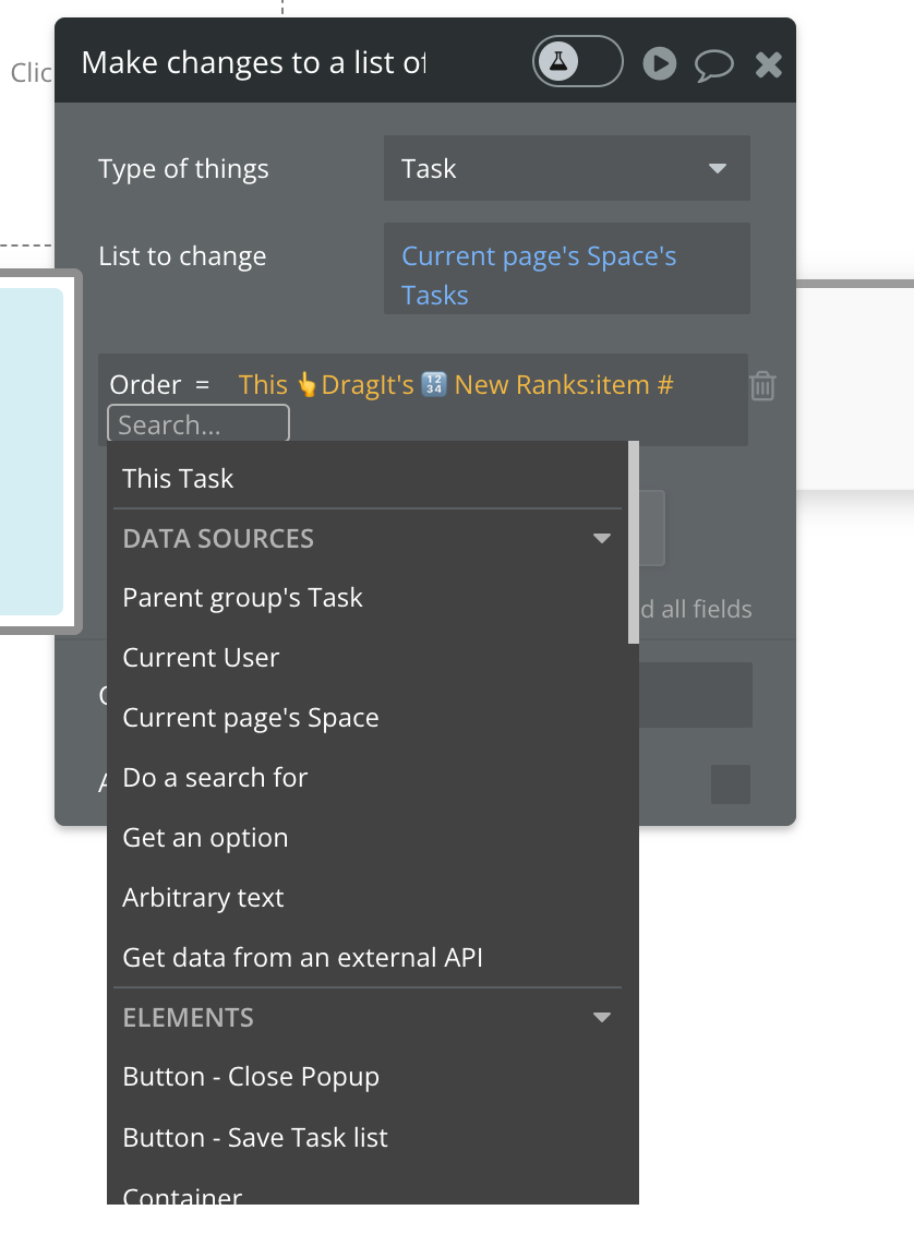

Hi Mike,
Apologies, you responded to my comment on another thread regarding the Drag It - RG to RG plugin. I should have provided some more context.
In the example above I couldn’t select “This DragIt”, I had to copy the reference from an example and paste it in (or I could have selected the input manually as a workaround, which I now know, cheers). However, I also can’t select the item after the “Item#” reference. I should be able to do “item#:This Items’ Rank” but I can’t :frowning:
I will keep playing around with it, see if I can figure out another workaround.
But thanks for the response and help, I appreciate it.
