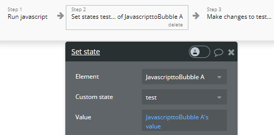

I created a script to sort images according to their labels.
This works fine. However, the data is not saved.
Both toolbox elements and states are updated with correctly sorted lists.
However, no matter what method you use, the data cannot be changed.
However, if I press the button twice, the data changes the second time. Could you tell me why?
Great that it works! If you find out why “x” matches everything, you’ll want to exclude the field named _id
Awesome, thank you!
Basically the workflow is seeing JS2B’s value as at the start of the workflow.
Did you try turn off “Asynchronous” in RunJS?
If it still has the problem, look at FAQ on JS2Bubble for an explanation and some workarounds.
Thanks for rapid answer. I already turn off it.
Can you check mine? look at asd page
if you do twice, it will change data.
so after that you should delete sorted image list data for next text
@studio.be.lazy The Bubble optimizer will see that at the start of the workflow there is enough data to run the database step on the backend, without waiting for the prior steps.
The saving part needs to be on another workflow, as described in the FAQ.
I did it! Thanks for explaination!

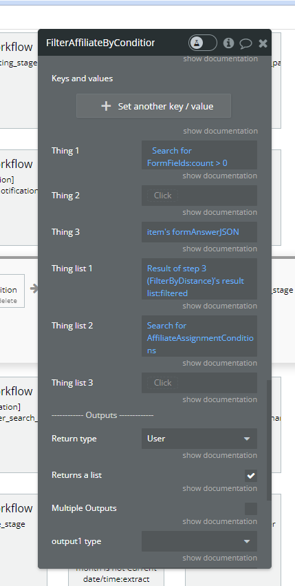

I’m running this code:
const log = [];
function listToArray(list) {
  if (!list) {
    return [];
  if (Array.isArray(list)) {
    return list;
  try {
    return list.get(0, list.length());
  } catch {
    return [];
function checkListLength(list) {
  try {
    return list.length();
  } catch {
    return 0;
function intersect(a, b) {
  var setA = new Set(a);
  var setB = new Set(b);
  var intersection = new Set([...setA].filter(x => setB.has(x)));
  return Array.from(intersection);
function contain(a, b) {
   return intersect(a, b).length === b.length;
function getField(data, name) {
  return data._pointer._source[name];
(function () {
const affiliates = listToArray(properties.thinglist1);
if (!properties.thing1) {
  return affiliates.map(aff => aff.get("_id"));
const rules = listToArray(properties.thinglist2);
const answers = JSON.parse(properties.thing3);
const affiliateToRulesMap = {};
for (let rule of rules) {
  const affiliateId = getField(rule, "affiliate_user");
  affiliateToRulesMap[affiliateId] = affiliateToRulesMap[affiliateId] || [];
  const choices = getField(rule, "choices_list_text");
  const formFieldId = getField(rule, "formfield_custom_formfields");
  affiliateToRulesMap[affiliateId].push({
     choices,
     formFieldId
const affByCondition = affiliates.filter(aff => {
  const affId = aff.get("_id");
  const rules = affiliateToRulesMap[affId];
  if (!rules) {
    return false;
  return rules.every(rule => {
     const choices = rule.choices;
     let fieldAnswer = answers[rule.formFieldId] || [];
     if (typeof fieldAnswer === "string") {
        fieldAnswer = [fieldAnswer]
     return contain(choices, fieldAnswer);
}).map(aff => {
  return aff.get("_id");
return affByCondition;
And on the version 1.3.1 of the plugin it worked, but with newest version 2.1.2 it’s not.

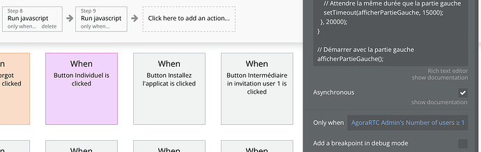

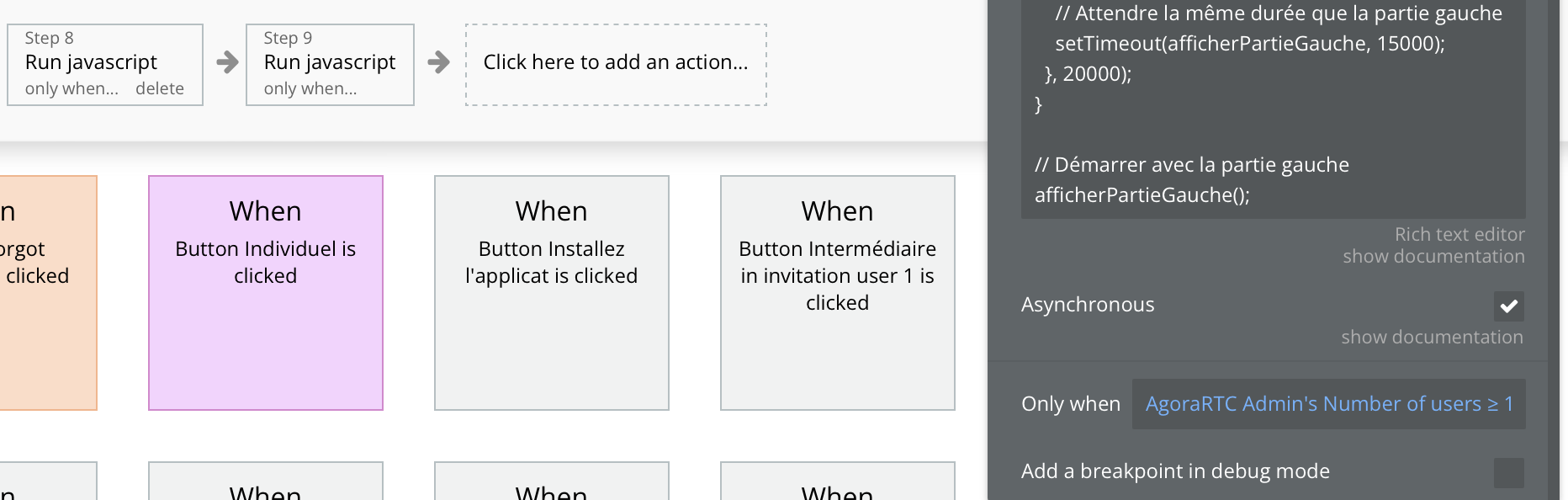

Hello,
Can we use 2 times the toolbox plugin (2 windows as on my picture) in the same workflow and set 2 different conditions so that when one of the 2 conditions is met it is one or the other of the plugins (one of the 2 windows) that is activated with its code, of course the code is different in the 2 windows.
Thank you very much for your help, I really need it.
@dev77 how did you go on converting your serverscript? Did you find the relevant page on Toolbox docs?
Tip: you’ll likely want to make async functions wherever they wait on promises, for example
becomes
async function listToArray(list) {
  try {
    return await list.get(0, await list.length());
  } catch {
    return [];
Then this
becomes this
return (async function () {
const affiliates = await listToArray(properties.thinglist1);

Yes that is a useful way to run conditional scripts.
You can also rename the workflow step to make it clearer about which code is in which step.

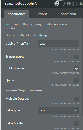

I’d also like to know what the JS part of the front end is for?
In my case I would like a group to zoom in, when a certain condition is met it will zoom out to the left and when a different condition is met it should zoom in to the center.
can you tell me more about the font part of the plugin please?
The element is intended to receive a call from Javascript, to raise a Bubble workflow event and set a Bubble value. If you upgrade the Toolbox plugin, it will show the url of a doc site, which explains more and links to a bunch of examples.
Can you say more about the condition? Can it to trigger an event? Or need it be checked on a polling loop?
Have you got a zoom technique you want to use?
If you are talking about JStoBubble’s style properties, they do nothing significant. The element is not intended to display anything.
Yes, the condition is to check a query loop.
And when I talk about zooming, I mean enlarging a group towards the center.
