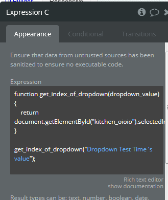

That seems to have been the case :slight_smile: Thank you! Although, I would’ve thought that this function would re-evaluate every time the dropdown changes values but it doesn’t :confused: Any idea how to get it update with changed values?
I figured it out… without actually referencing the drop down the expression wouldn’t reevaluate every time the dropdown changed. So I made a dummy function that took the dropdown as a dynamic input and then generated the index by direct attribute selection.
function get_index_of_dropdown(dropdown_value) {
    return document.getElementById("kitchen_oioio").selectedIndex;
get_index_of_dropdown("Dropdown Test Time 's value");
See:

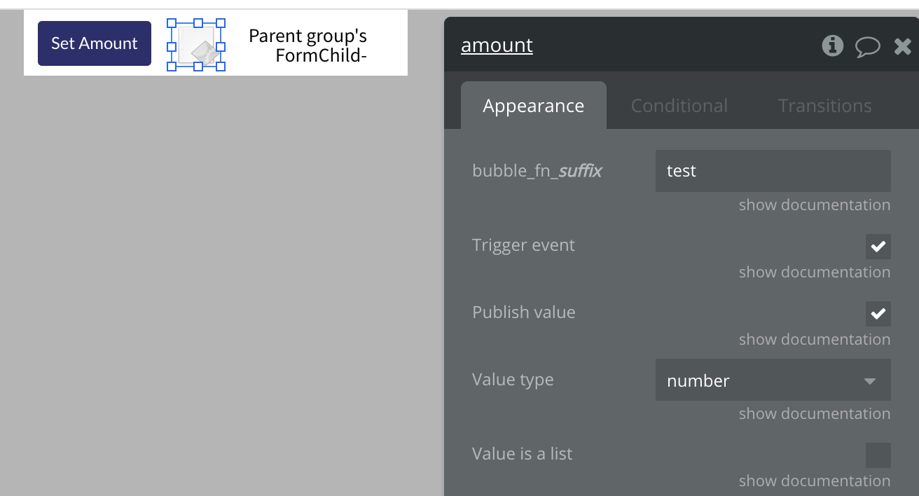

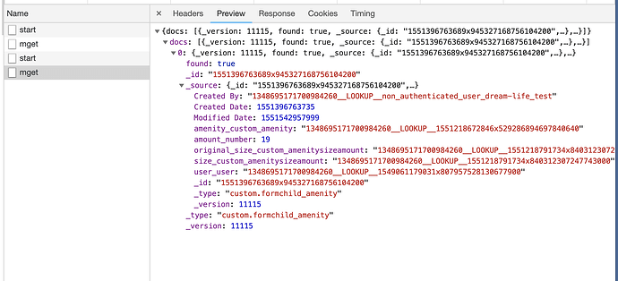

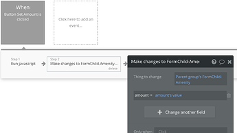

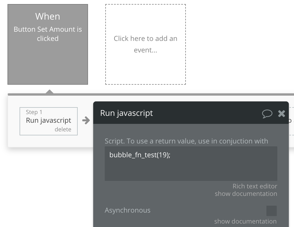

Interesting behavior here, where I set a db value using javascript to bubble element, it fails on the first attempt, and works on all future attempts. I’ve stripped it down to the following basic test:
Gives me:
1rst Click:
2nd Click:
Notice that the amount_number is only showing on the 2nd hit.
If I simply set a value instead of using the javascript to bubble element, it all works fine.
Am I just being a knuckle head and doing something wrong?
Appreciate any help here!

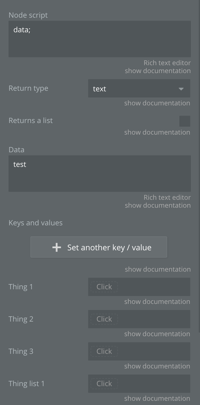

I’m trying to use server scripts exclusively as state for API workflows, like a variable. Even my most basic example causes an error.
Here is the workflow, after which I do a “Return Data from API” although even without that return workflow it will throw the error.
In Postman, this is returned:
“message”: “Unexpected server error, please try again later”
When I go into the server logs, there are two sequential errors:
Workflow error - ret_val.custom_type is not a function
Am I doing something wrong?
I’m guessing data should be “text”, since you want to return a string.
@miguel The return type is text, isn’t the data field for the text itself?
What I mean is that the text test might need to be double-quoted (or single-quoted), since what you want to return is a string.
But I have not tried it.
I see. I gave that a try just now, it did not work either.

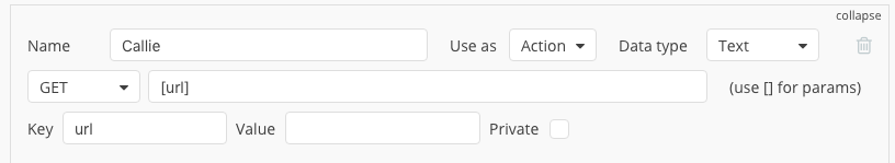

I’m trying to send a stringified json result from an external Bubble APP Data API call to a RG. For this I’m using the JS to Bubble and Expression elements.
However when I do so it seems that the JS2Bubble element is adding commas and creating an array with all the chars in the stringified JSON.
Apiyo - Callie sends a json formatted as text.
Any tip or hint would be most appreciated :slight_smile:

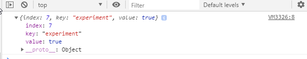

I have a small issue/(misunderstanding ?) using bubble to java script in my app (value type : yes/no)
I fill it with a list of booleans by parsing a json string where the value is : ,“experiment”:false,
I then flip the values using a ionic toggle set to trigger :
I inspect my custom-state holding the modified values and it seems to be an ordinary boolean value
Trying to iterate my list to create an object to stringify, I get an error: no is not defined, or “nei” as it is in my native tongue.
I’ve tried using strings, numbers etc as the boolean value but there is always some fuss when either saving/parsing og stringifying.
When i inspect the element it says : nei = no
why not false,false,false etc…
Is there anything special as to how toolbox or bubble is handling lists of booleans, shold i just use strings ?
Is this just a common json parse/stringify problem :wink:
Anyone else found a solution/compromise ?
Are you setting bubble_fn_experiment in the JSON Updater custom event?
The screenshot you posted shows that you are passing what you apparently want to that custom event. What does the custom event do with that workflow thing?
