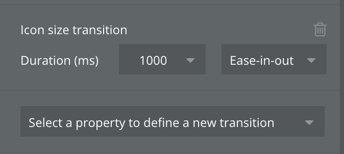

Is anyone else seeing an issue where Transitions seem to be completely non-functional?
I have tried a zillion different combinations including testing on different elements (icons, groups, text, etc), different properties (size, width, height, color, etc), different timing, and different curves (ease, linear, etc).
I end up seeing absolutely nothing different than without the transition.
Anyone else seeing this? Maybe I’m doing something wrong, but I cant think of what it would be.

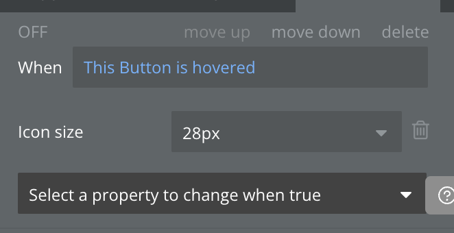

Below are screenshots of how I have this set up…
There does appear to be an issue with icon size transitions on button elements. For me, the size does change, but there’s no animation. Other properties - e.g. width, margin, etc. - seem to work just fine. I use them in a number of places on various elements.
What’s the original size of your icon? You should definitely see it change on hover, even if the smooth transition is not working.

icon-size-transition
Normally SVG width, height and font-size are transitionable CSS properties. I’m not aware about how Bubble implements icons in buttons - if it’s not working I suspect the icon may be appended via JavaScript, which forces a re-render thus no transition can be applied.
I’ll try the padding idea. Thanks. - I wasnt able to make any of the transitions work. Color, size, etc… But I’ll try the padding idea.
