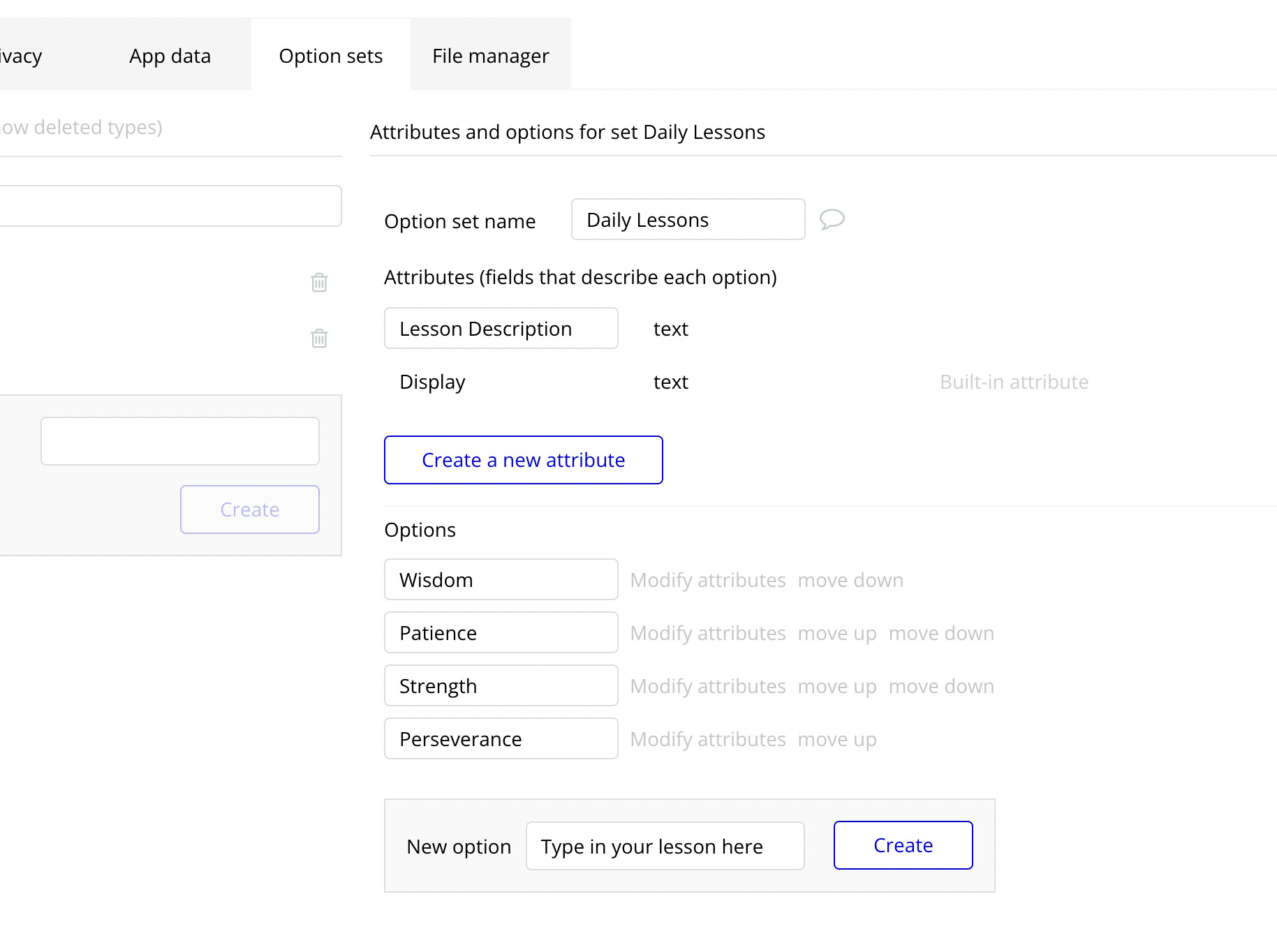

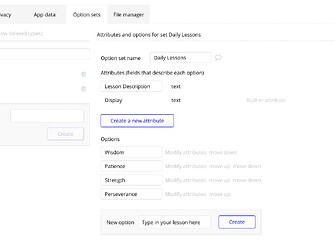

My approach would be to use option sets
Option Set Structure
Step 1: Create your option set call it, let’s say, “Daily Lesson”.
Step 2: Create a new attribute of type text called, let’s say, “Lesson description”
Step 3: Add all your daily lessons and then modify each of their “Lesson description” to what you want that lesson to say in detail.

So, I got immediately stuck (did I mention I’m a complete newbie). I was able to add the option set and attributes, but I’m a not quite sure where to add the daily lessons. Should these be on a page or somewhere in the data tab. Also, since there are multiple lessons should the option set attribute be set to a list of texts?
Thank you, again, for the help!
No worries,
You add each of the lessons in the option sets tab.
Also, the attribute should not be a list of text. You are creating many lessons, each with one single text description.
Your Lessons
Type in what you want the lesson’s name to be and click “Create”

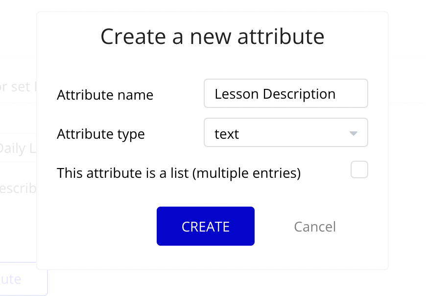

Your Attribute
Create the Lesson description by clicking “Create new attribute”

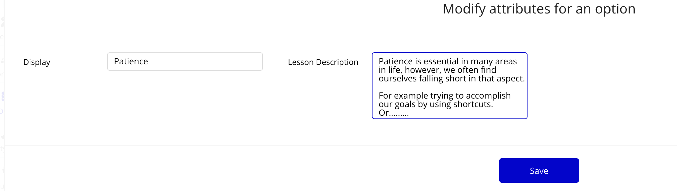

Your Attributes For a specific Lesson
Modify each one of the Lessons you’ve created and type in a lesson description
