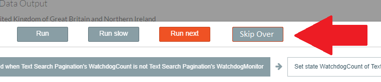

Also…on the debugger, when you switch the view to “Step”, can you implement a “Step Over” next to the “Run Next” so individual actions can be skipped for testing purposes…like below;
Thanks.
Dave
Not sure I like the button in edit mode, as we’re talking about a run mode behavior and it’s a bit confusing, but i like the skip button much more :slight_smile: We’ll think about it.
