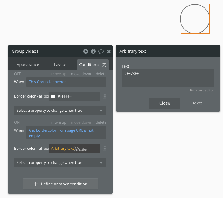

Hi, seems it works on my side with this setup:
Does it work adding border style all solid to the condition?
Is your parameter correctly written in the URL?
What border color do you obtain in your case ?
Any custom CSS that could overwrite it ?

I created an example for you that takes a color from a random color plugin using a url parameter. Check it out:
Editor: testApp42wCleanDB | Bubble Editor
Preview: https://testapp42wcleandb.bubbleapps.io/version-test/url_parameter_for_custom_border_color?debug_mode=true&color=21
Does that help? :blush:
Thank you. It just doesn’t seem to work in the preview, but when I tested it on the site, it did.
Yeah, it won’t work on the preview with arbitrary text. :blush:
