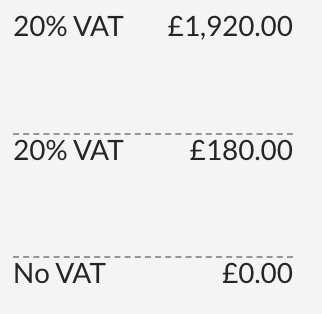

I started trying to use a repeating group, but having issues as I can’t link 2 data sets. I have managed to show all of the line items one by one, but can’t for the life of me work out how to remove duplicate Tax Rates, and have a sum of each line items tax amount next to it for that rate.
Here’s an image of my RG - there’s 3 line items. 2 have 20% VAT as a tax rate. 1 has No VAT (0%) as a tax rate. How would you go about having 1 line for 20% VAT in a RG and combining the £180 and £1920 together?
need to use group by
group by tax rate, sum of tax total
the group by reference can just be the line items repeating group
