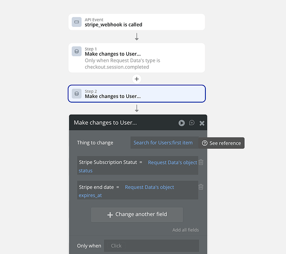

I’m slowly starting to dive into Stripe for a personal project. I set up a webhook that triggers whenever a subscription is CRUDed. In the next step of my workflow, I want to update based on the request data I receive, but it feels like my search constraints (using the request data as the base) just aren’t working.

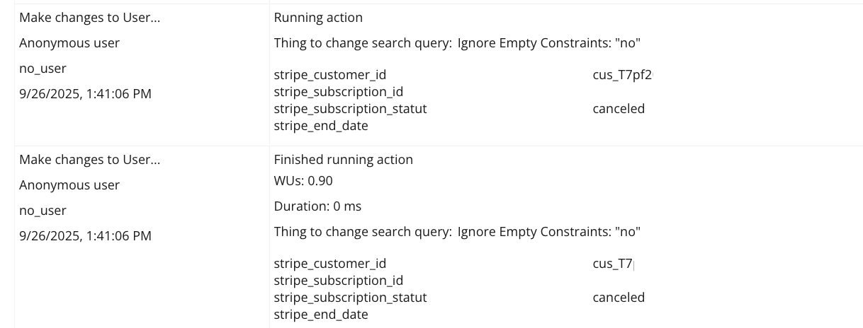

The payload looks fine — honestly, it really feels like the search constraint just isn’t being applied properly. Concrete example: when a subscription is canceled, it triggers my webhook, I run a search on my users with the matching Stripe ID to update their status to canceled, but nothing happens (see screenshot).
I tested privacy settings, that’s not the issue. For context, without a search constraint — e.g. if I just do “search user first item” — the update to canceled works fine. I think it’s something super obvious, but I’ve already spent more than 2 hours on it, so I’m looking for a bit of objectivity here.
Note : I confirm the ID is present and i tested with a fake data using create data thing action to get the id from teh request data. I confirm the ID is created on it
Just to clarify, I’m not using any plugin or API call, I’m doing everything directly via the Stripe portal. Gracias!

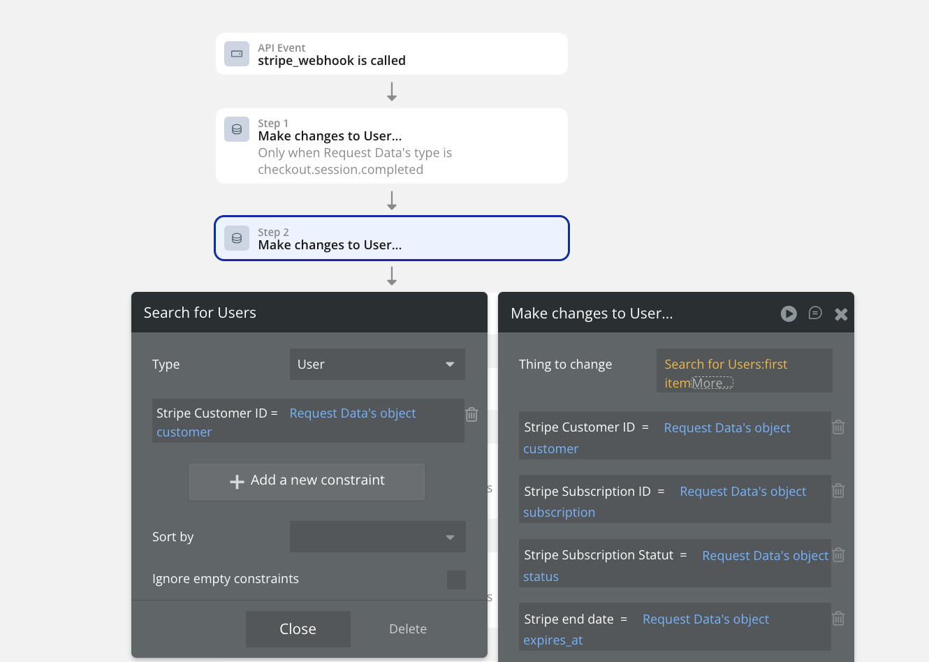

Why are you setting the Stripe Customer ID in this change action if the User already has a Stripe Customer ID (you’re even using it in the search constraint)?
And how/where are you setting that in the first place?
I’m pretty the reason this is not working is because, contrary to what you might think, the User does NOT have a Stripe Customer ID when this search is being made.

I have a first step where when a customer + customer is created, it updates a user (screen 1) then i have the other step where in fact as you said i can remove the IDs update which i did but still not working.

I tried many things, still it seems the search do not get any results and i cannot understand why. I removed unnecessary steps, tried to use plugs in, but nothing is working. I removed privacy settings to check, nothing as well. I m missing something bnut im not sure to understand why … if you guys have a clue … And i tried to manually add customer stripe ID, still the workflow do not update anything. thanks for your ideas if you have !
I see you’ve mentioned privacy rules a few times, so first quick tip is to ignore privacy rules in webhook workflows. Since you’re not returning data through the API or authenticating the incoming request, there’s really no reason to apply privacy rules in the first place.
Next, in your “Search for User’“, don’t “ignore empty constraints”. If for some reason the Stripe API returns an empty response, the search will return all of your app’s users, and the “first item” could be anyone.
The only reason I can think of why the search wouldn’t return any user is that no user is associated with the customer ID in your database.
